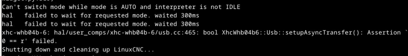

I found that if I try to jog when a g-code program is running, the pendant will disconnect every time. The reason is too long blocking (like I mentioned in the first post) without USB polling. The pendant will request manual/teleop mode (I don't recall which) and wait for minimum 300 ms if the mode does not change. It's these two functions:
github.com/LinuxCNC/linuxcnc/blob/master...6/hal.cc#L1361-L1420
I solved this issue by reducing the "loops" parameters here:
github.com/LinuxCNC/linuxcnc/blob/master...b04b-6/hal.h#L71-L86
Maybe your issue could be because of the same reason?
Still, if I use the mill for an hour or so, the pendant is likely to disconnect. And I have not found any specific reason for that yet.

07 Feb 2026 08:15 #342587
by Hakan
Replied by Hakan on topic XHC WHB04B development?
Tested today, but not very conclusive I'm afraid.
Default master branch.
Jog while running Gcode: Doesn't allow me.
First time running gcode, press stop. While in Auto mode spin the wheel: It crashes see screen dump below.
After restart and retry this several times: It works, it switches to Man and moves in Z.
With loops=10, it always works, at least the say five times I tried so maybe not conclusive.
I can continue with this setting to see if it fails later.
I always get this "assert" error when it fails.
