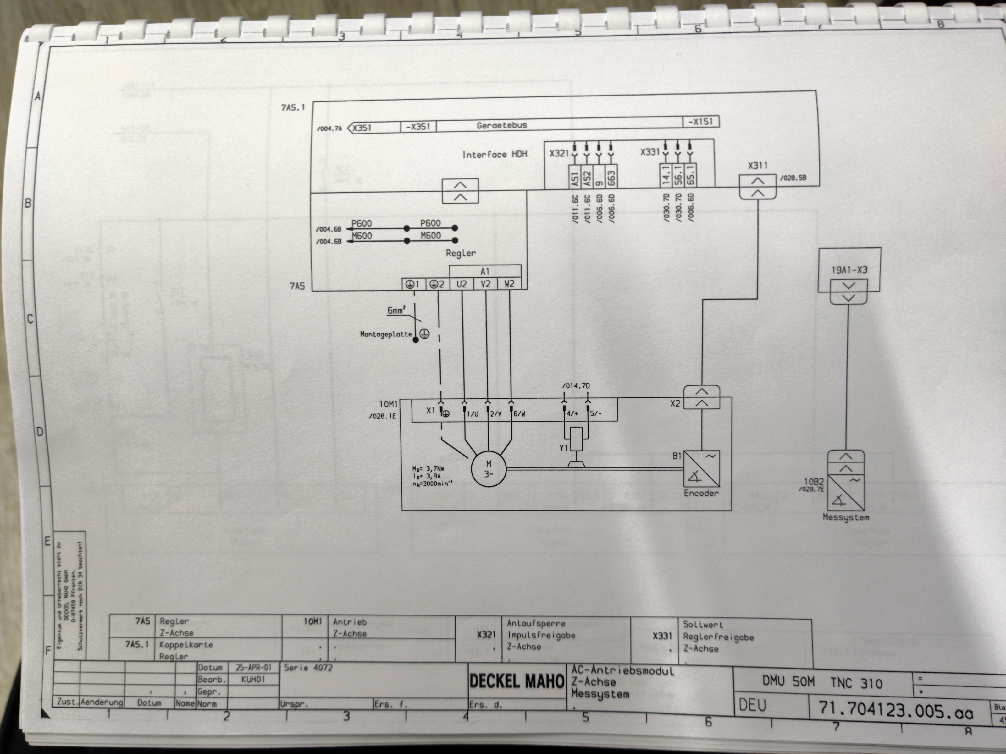

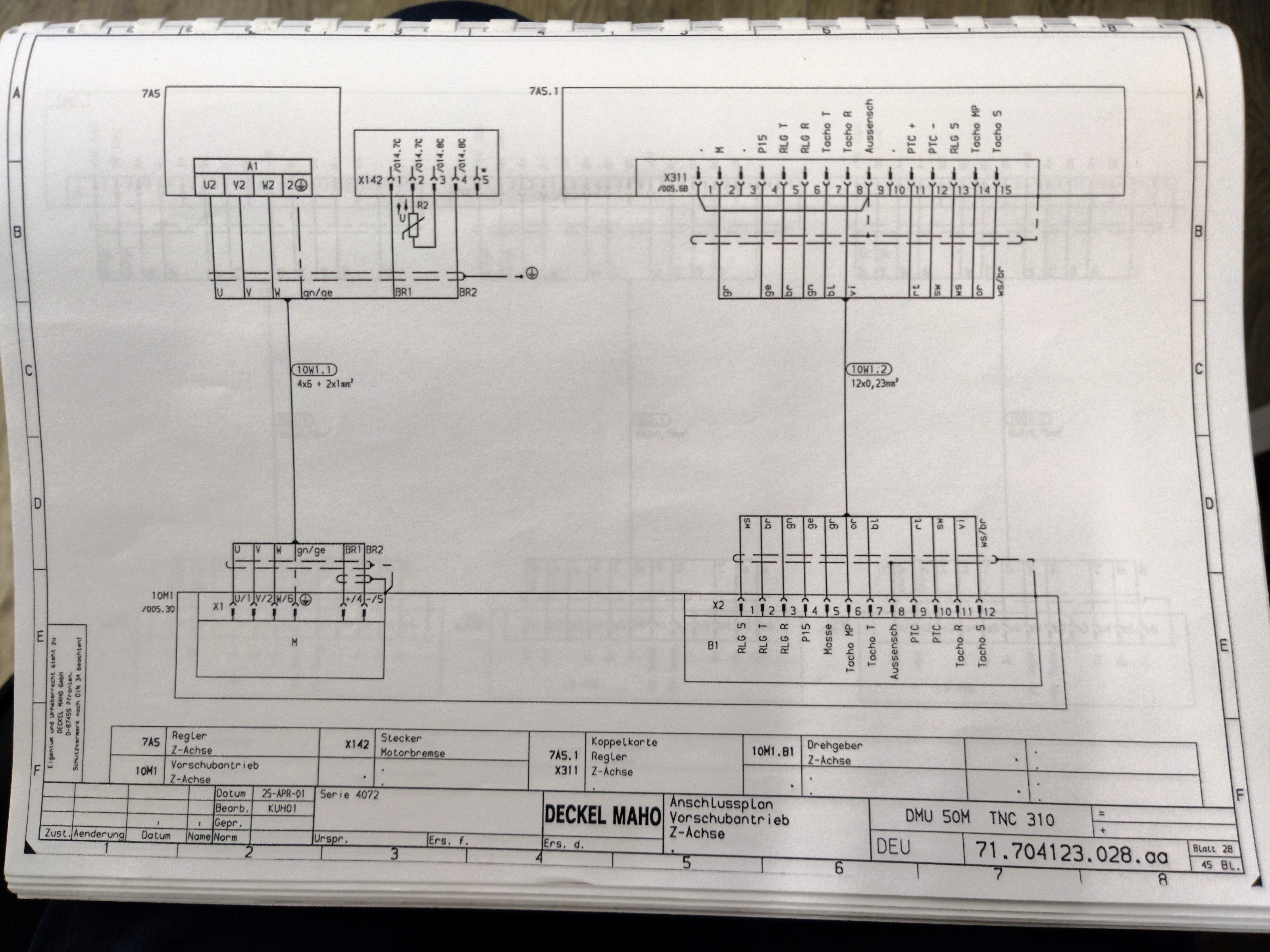

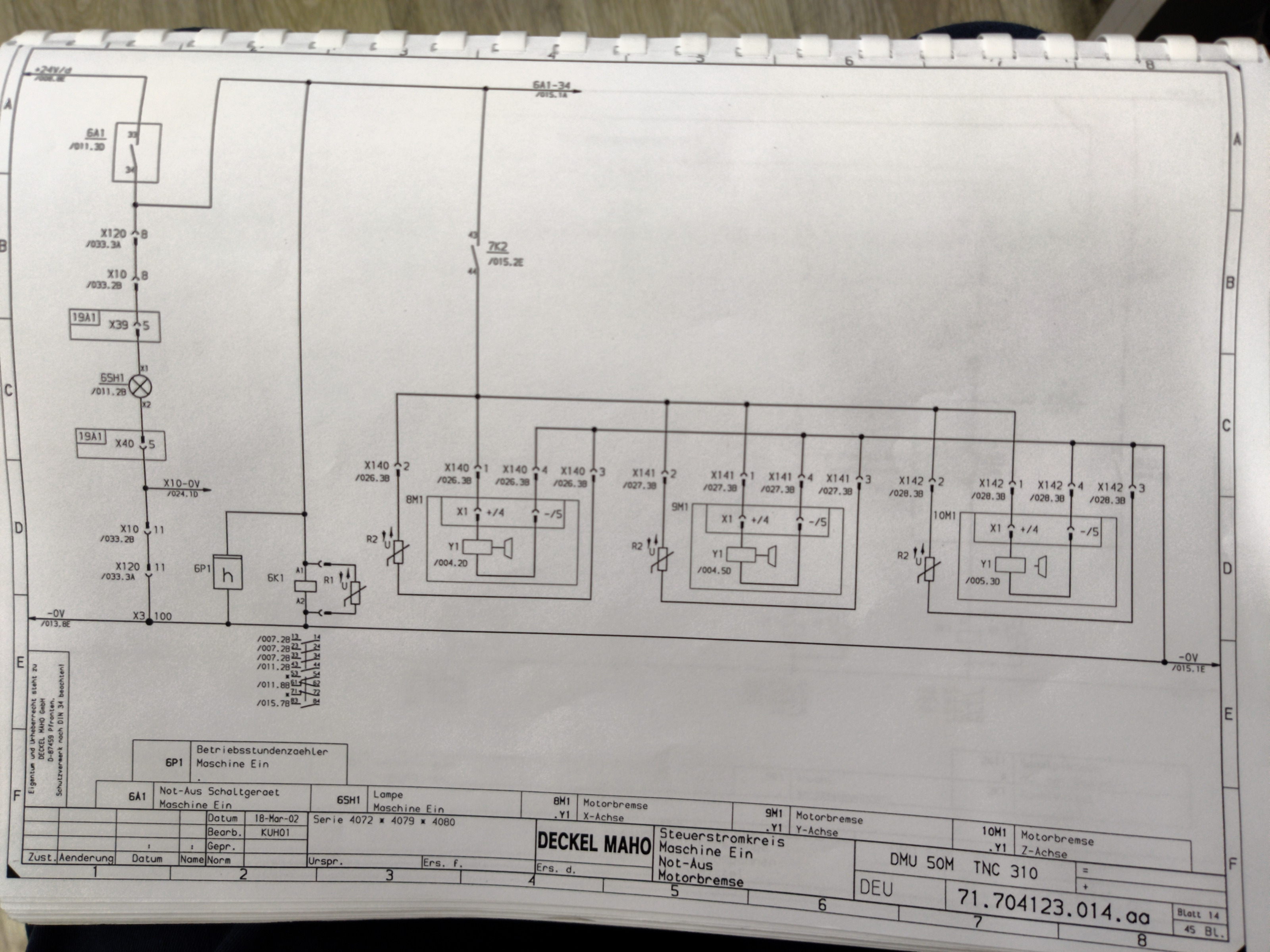

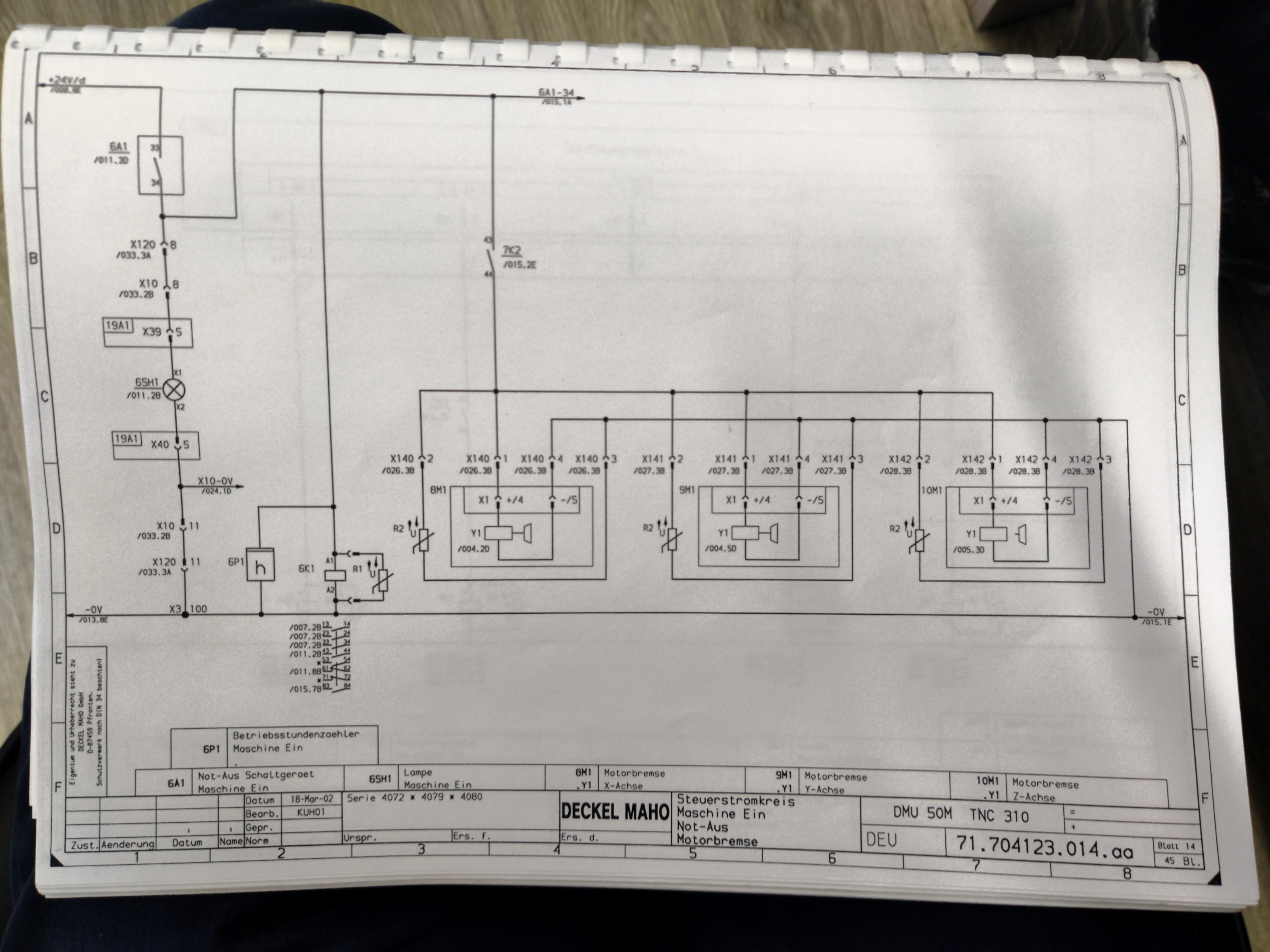

Yes, I probably worded myself confusingly. The *signal* for the brake is a single one for all 3 axes, but the brakes themselves are separate.I am attaching pictures of the electrical diagram that mention it. One is Motorbremze Z-Achse and at the other instance is Reglerfreigabe Z-Achse. Assuming the Regler (regulator) is supposed to interface the brake?

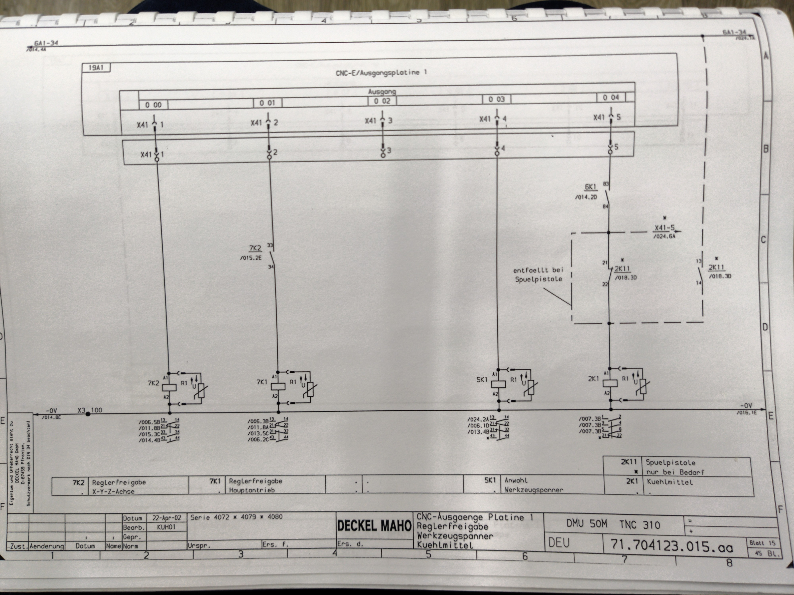

However, I do not think I have a signal for the brake itself. The only output signals from the controller to the drives I have are — Reglerfreigabe X-Y-Z Achse, Reglerfreigabe Hauptantrieb, Anwahl Werkzeugspanner, Kühlmittel, ...many empty ones..., CNC-Fehlermeldung, ... many empty ones..., CNC-Betriebsbereit. So that's essentially 5 signals with 29 unoccupied ones.

I'm coming to the conclusion that the Regler power on electrically triggers the brake release. In the page I've attached, that's what it seems like. So it is probably not possible for me to interface them separately. Then again, the brake release having the regulator (7K2) as a prerequisite, should ensure the brake isn't released without the drive being powered on, no?

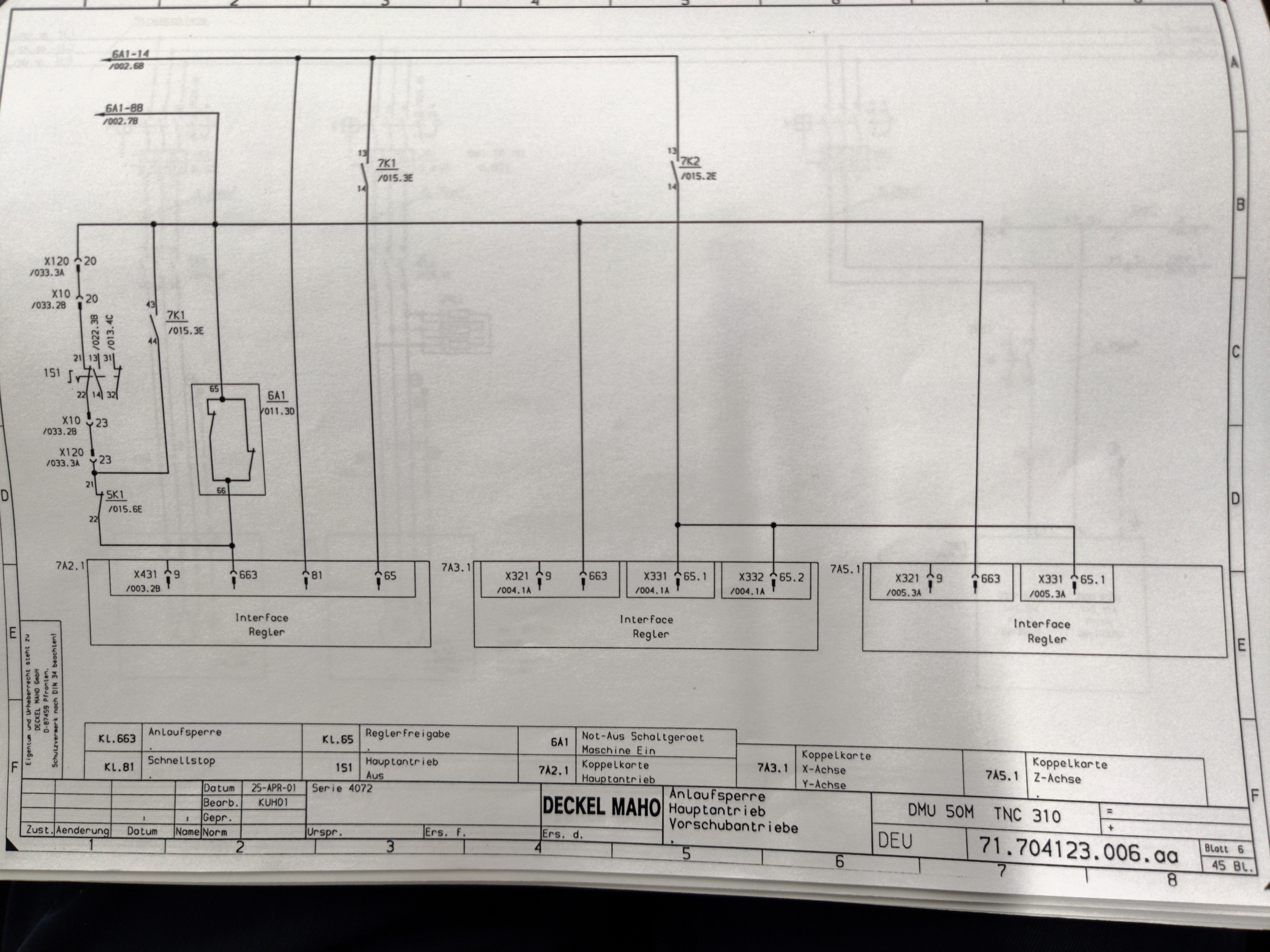

Regler (DE) = servo driver module (EN). On my machine it is the Indramat, on yours it is the Simodrive 611.
7k2 is not the servo driver is it? DMG terminology would be that 7k2 is a 24V control relay. On my machine the servo drivers (the indramats) are called 7A1 and 7A2. On yours the Z axis drive is 7A5 (you probably have three separate servo drives on the axis, another on the spindle, and maybe a fifth on a C axis? I only have two.
The brake releases as soon as the 7K2 relay closes. What is the signal chain which energises the 7K2 coil? That needs to happen at the same time as the Reglerfreigabe is commanded through the X331 terminal block on your Simmodrive.   What are the three signals in the X331 terminal block? I would guess the Reglerfreigabe signal , a gnd and maybe the third wire in that cable is a "driver enabled" feedback to the CNC controller. Alternatively, it could be a "Servo Drive Fault" signal.
How did you tie them into LinuxCNC? You need to be setting whatever pin in X331 is the drive enable to active, at that same time as you are energising the 7K2 relay.

I believe X331 contains the Sollwerte and the Reglerfreigabe. The Sollwert has 0V and ±10V connection, so that should be three. The Reglerfreigabe signal links to a different page where it shows it on an Interface Regler and the signal is listed as Kl.65 or 65.1. That in turn is dependent on 7K2. (page attached)
Yes, 7A5 is the Z Regler and 7K2 is its Freigabe relay, right? I believe 7K2 is energized only by the single output signal on X41 (attached page). The other 4 references to it show where its output goes. Regarding how I link that to LinuxCNC, I certainly am not linking the X331 signal to the Mesa directly. I don't see an obvious way to, nor do I think it initially went into the Heidenhain controller. From the looks of it, the signal on X41 that energizes 7K2 relay should be what handles the X331 Reglerfreigabe. It looks to be sequential, meaning X331 will be set after 7K2 closes. Am I understanding this backwards?

I took another look at my Maho's schematics. Seems similar except my 7K2 relay control is hardwired into the "machine on" latching circuit rather than being directly controlled by the CNC.
This browser does not support PDFs. Please download the PDF to view it: Download PDF
Because this is a hardwired signal chain, E-stop drops K1, breaking the chain and therefore dropping 7K2.
So on your set up, LinuxCNC connects to X41 and controls the 7K2 relay, which similtanously enables the drives and releases their brakes. If that is the case, then I have no idea why your axis is dropping, as the Zaxis is getting enabled at the same time as brake release.
Since you suspect a correlation with E-Stop, could it be that E-Stop is not dropping 7K2, leaving the brake off, but some other signal deactivates the drive, so you end up with brake off and no torque? Basically your more modern controller was replacing the hard wired E-Stop chain with some software PLC functionality which you haven't duplicated in LinuxCNC yet?
