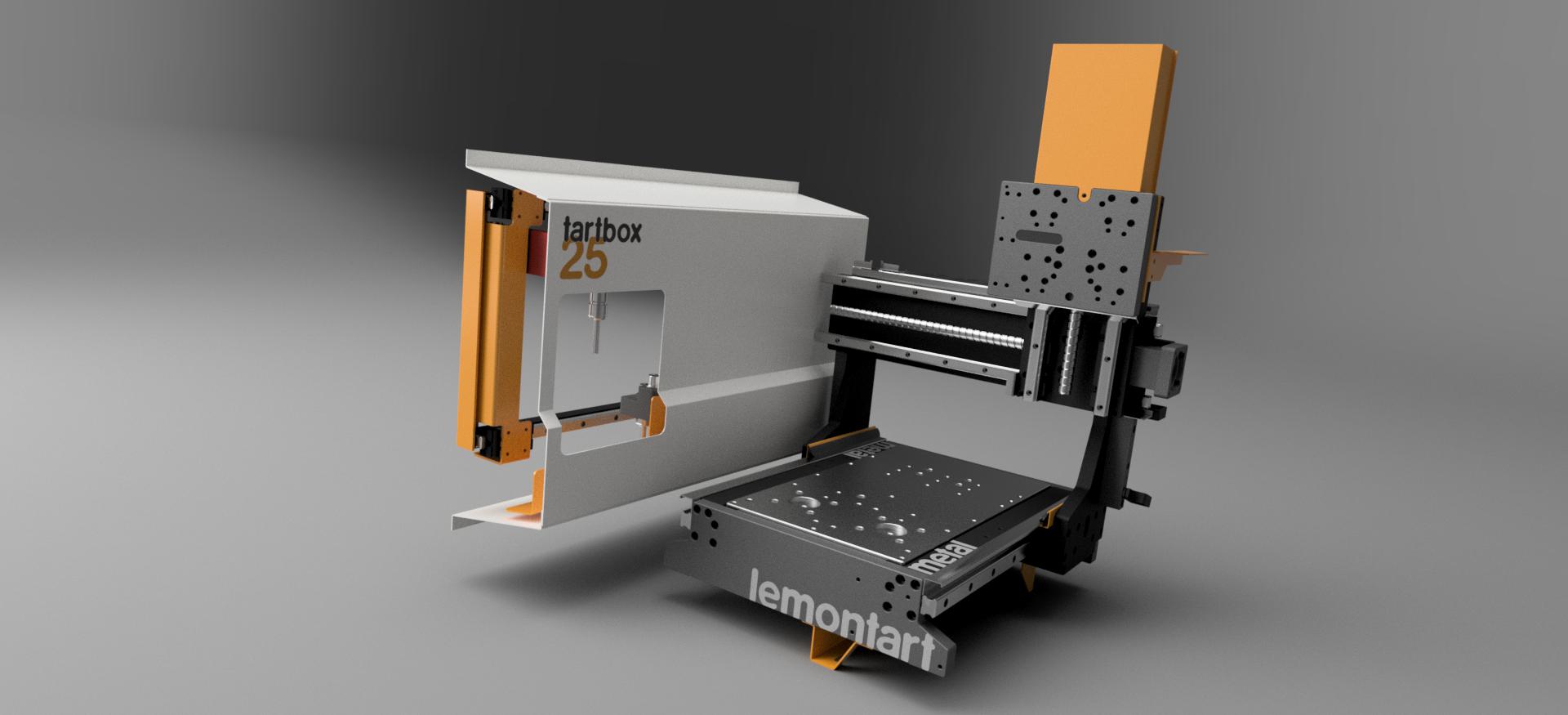

So i had a craaazy idea for a little robot tool library.
Wondering how you would implement it in linuxcnc.
So we have our XYZA on our cnc. lets reserve B just in case we ever need a 5th.
That leaves 4 more axes available.
Our little tool robot will have an x2 y2 z2, and a x3 (fixed motion, likely air) and C do pivoting the gripper - again fixed motion.
Basically it is a cnc of its own, and needs to operate while the main machine is cutting so it can sort and stage tools. This is different from using C for an atc platter that is actually coordinated with the main machine.
How could we do this?can we decouple these new axes from the main motion as a "channel" ?

oooh. yeah we can 100% just have single axis at a time motion for this.
thanks, ill look into this.
The devices is starting to take shape here
Replied by ihavenofish on topic motion channels for robotic atc library
A “HAL-only second planner” is technically possible, but then you own all the safety, limits, interlocks and coordination logic yourself — and it tends to become fragile fast.
If the toolchanger robot only requires point-to-point motion and doesn't require circular or linear interpolation, then extrajoints can be used. Basic safety chains, homing, and limits will work as for other regular joints. However, for motion planning, you need to connect the simple_tp or limit3 components. Their motion calls should be implemented in custom M-code (e.g., M100 P1.2 Q23 ...).

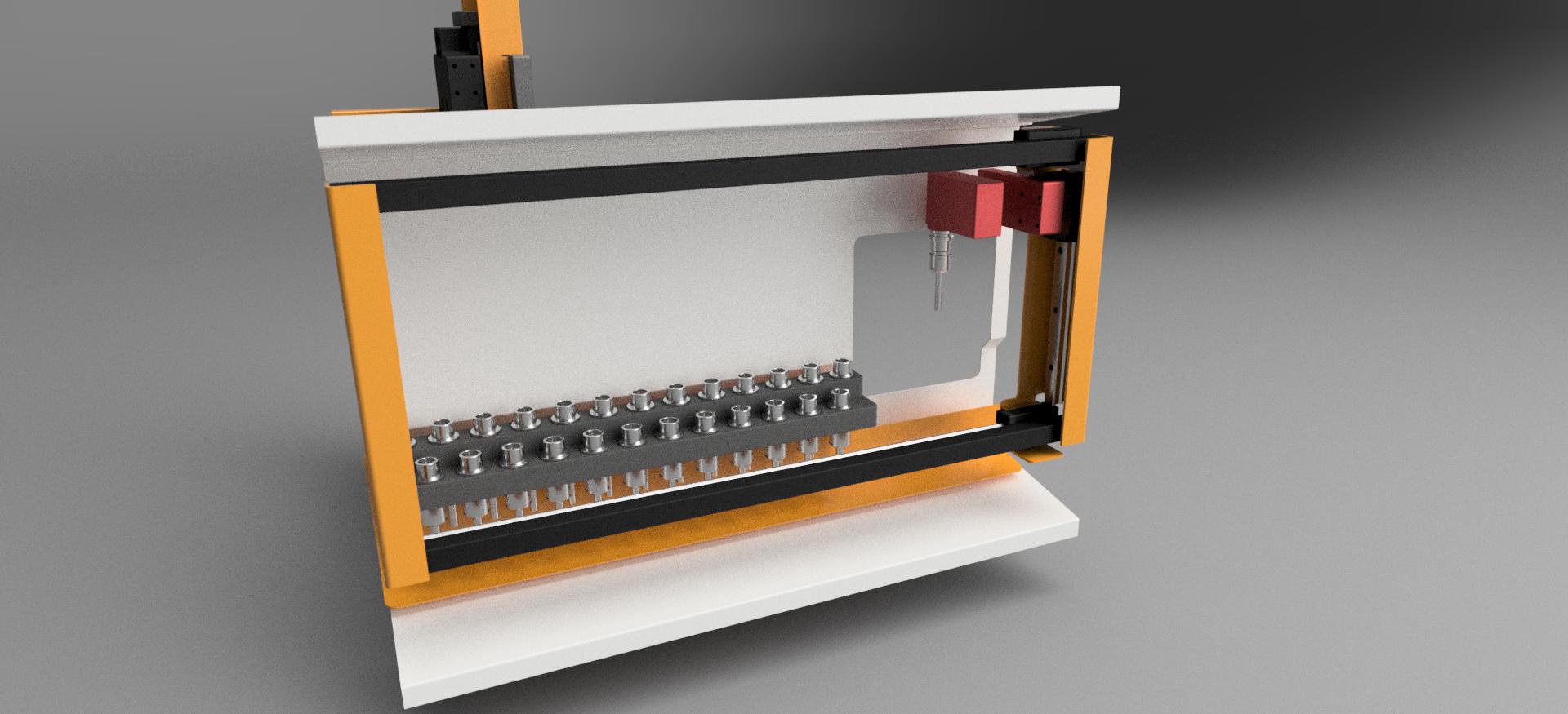

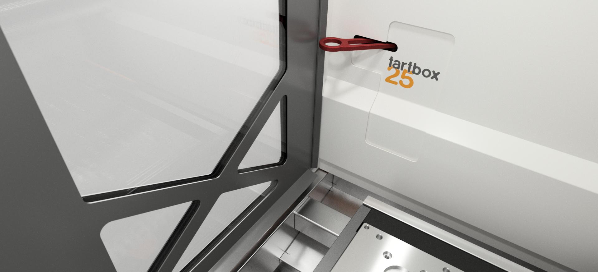

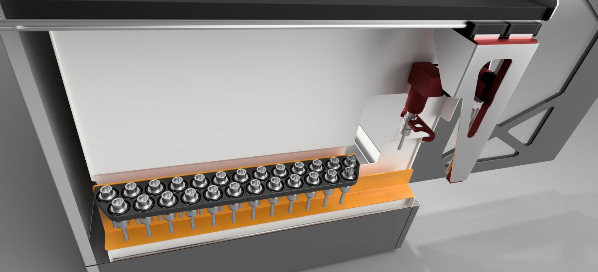

So we have wound up with a simple little 3 axis cartesian robot. Robot basically has a spindle taper and air powered gripper, and then hands off to a switcher arm that will be moved by the little robot with a roller cam.
I will probably build this in april, then we can see if it can live inside the master linuxcnc or needs a separate controller.
So the run down:
- X, Y, Z linear motion.
- gripper air cylinder.
1: Robot on its own goes to grab the next tool needed by the machine, and places it in the arm SLOT A
2: M6 Tx called
3: Robot uses cam to move arm out into position. Door opens on the same linkage (we could also do this with air)
4: Machine moves to tool change arm and places the tool in SLOT B
5: Then it grabs the tool in SLOT A and moves away from the arm
Basically the main control sees the atc as a stationary rack type with only 2 tools
6: The arm retracts in and door closes
7: Machine resumes cutting
8: The robot takes the tool from SLOT B and puts it back in the right pocket
9: Robot grabs the next tool in the program and we repeat everything again
Make sense?
So the run down:
2: M6 Tx called
Make sense?
