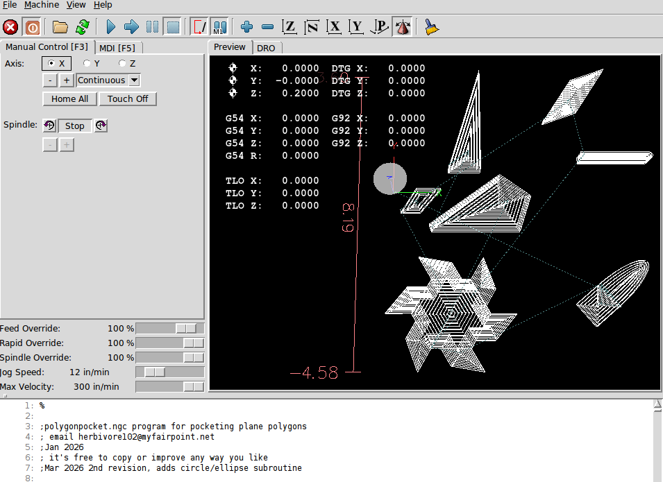

here's a screenshot and a pocketingprogram

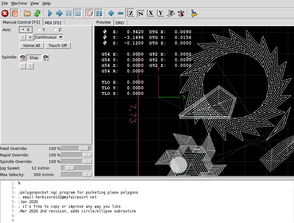

Some think that circles and ellipses are polygons as well. So I added a ellipse pocketer subroutine (which does circles too) to the program, and here it is, I also "sharpened up" the vertices of the polygons a bit. See the screen dump for how well the "half ellipse" fits with the square.

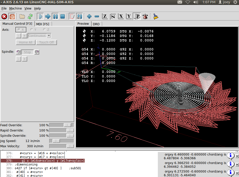

Replied by 858PSJ on topic pocketing program

This was originally supposed to be just a tough shape to pocket, it looks like it could be used for making a saw blade too. The algorithm used to develop the perimeter would be prone to accumulate minor errors into major blunders since it accumulates multiple executions for sine and cosine functions to add up to a complete closed polygon. The verbosity setting prints out the value that is computed by the program to be the "last side". This one had a last side that was .065" bigger than the other 19 teeth. repetitive editing of the apex angle of the 19 teeth eventually resulted in a "last tooth" that was .0015" too small. Verbosity set to 3 dimensioned a bounding box where width was .00065" less than height so the shape is reasonably round, I did draw a circle around the tooth tips and couldn't see any big (or small) ones so when I decide to mill this at least the database will be more accurate than my mill.
I added the circular area inside the part since I had left it unfinished on my previous post, the screen shows the circular path but doesn't show the boundary circle I used to eyeball "roundness", nor does it show the center mounting hole which took a pile of g-code to finish.
the program is still g-code in its entirety, and its gotten pretty Hackey lately.

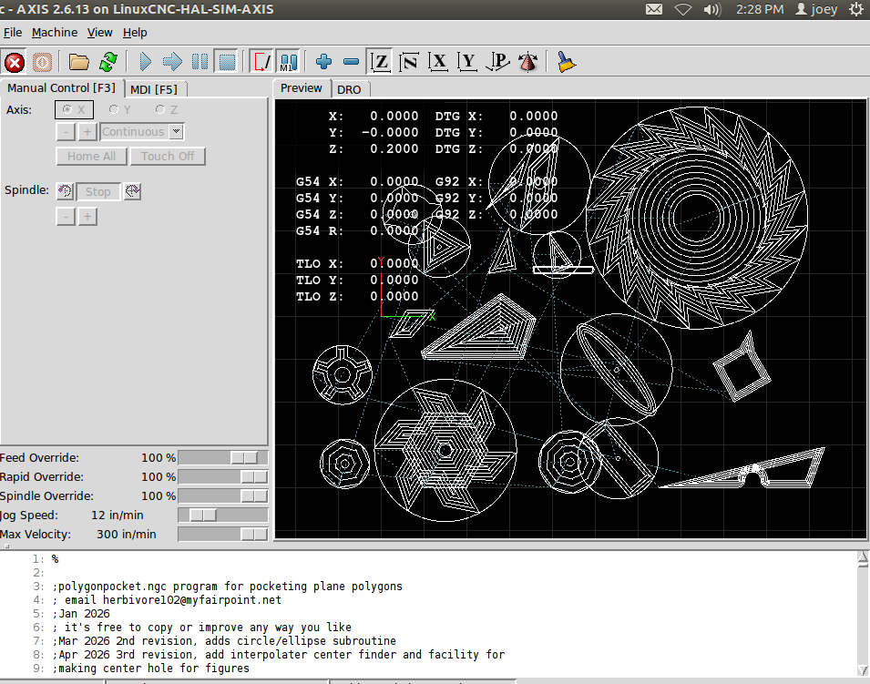

In the process of adding the center finding code I discovered a bug in program and fixed it. In the meantime I've added a small amount of g-code to facilitate cutting center holes in the figures. (sorry) Any form that is encoded can be machined out by setting traversals to one and adjusting passesneeded cuttingfeed and cuttingdepth to proceed downward until it cuts the perimeter. This has nothing to do with pocketing aside from the fact that traversals control is needed there. The addition of a center hole makes the program very handy for lots of other stuff. Center hole cutting begins once one pass of the perimeter is milled and cutting the perimeter resumes once the center hole has executed the specified number of plunges which is a subroutineparameter passed in with the original call. I have a screendump of the new stuff which also has the circle/ellipses Do I just dump that stuff here? The centerfinding code draws a reference circle overtop of the figure which makes the screen dump look crowded (see the attached picture.
