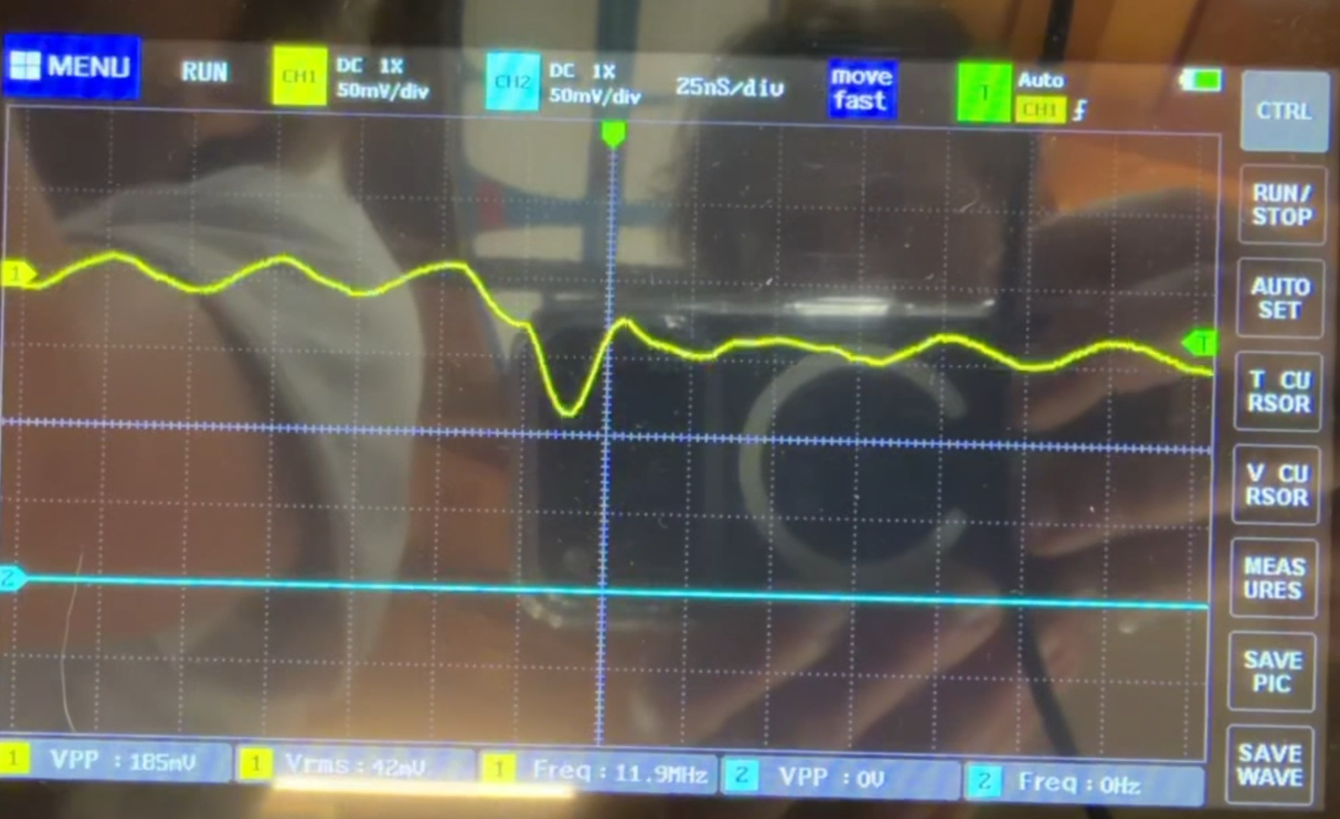

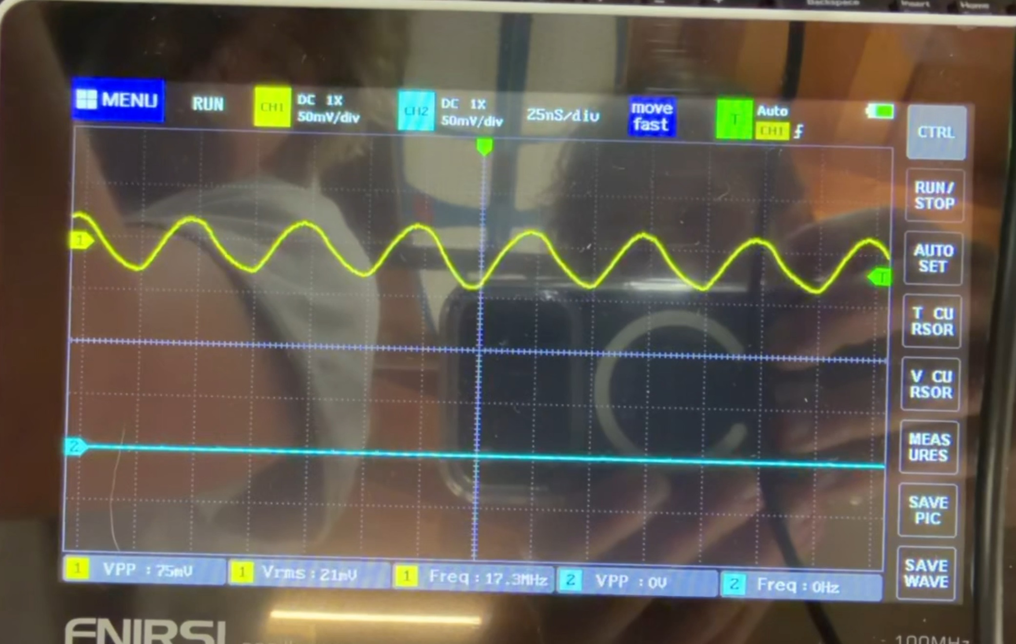

Hi, I'm trying to get my motors running with LinuxCNC, and I have an old controller for the machine that can move the motors, but the card reader on it is broken. I have tried many times to get it working with LinuxCNC, but now I've tried to diagnose it with an oscilloscope on the old controller. For the x-axis output, the step pin outputs a constant 20MHz signal when not being told to move, but when being told to move, it outputs a 12MHz signal. Image 1 is the motor not moving (Consistent wave), and image 2 is the motor moving (weird-looking wave). I took a video of them side by side and is linked to a google drive. If anyone knows how I can replicate this signal/frequency in LinuxCNC, that would be greatly appreciated. Thanks. Link to video --> drive.google.com/file/d/1qQ6TFAT_yjkfDdm...Lns/view?usp=sharing

At 75 and 185mVPP, those look like noise, not a signal of any kind, although the first one is weirdly clean sinusoidal.

Yup, that's noise. Your scope settings are so "zoomed in" in time and voltage you probably can't see the real signals.
- Set your scope's Y axis (voltage) range to more like 1V/division. More if the signals are (eg) 24V.
- Set a trigger on a rising or falling edge, with a threshold of something in the middle of your signal voltage range. Eg, if it's a 5V system, set the trigger at 3V or some such.
- Change your X axis (time) to much longer. This depends on how fast you're moving the motor, but 25 ns is way too fast to see the signals you probably care about. Something more in the 100 us or 1 ms range probably makes much more sense.

After another glance, 17.3MHz !!!
That is the realm of radio frequencies, not something you find on a machine.... usually.
