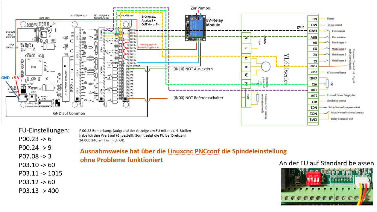

Hello guys,
im new in Linux CNC i wat to connect Linux CNC with my Spindel+YL620a Frequency Converter
via a 7i96s and failed. I dont understand what im doing wrong.....
I connectet the Components like the Picture.
Added this to the Hal
setp hm2_7i96s.0.pwmgen.00.output-type 1
setp hm2_7i96s.0.pwmgen.00.scale [SPINDLE_0]OUTPUT_SCALE
net spindle-vel-cmd-rpm => hm2_7i96s.0.pwmgen.00.value
net spindle-enable => hm2_7i96s.0.pwmgen.00.enable
Added this to the ini
MAX_OUTPUT = 24000.0
OUTPUT_SCALE = 24000
OUTPUT_MIN_LIMIT = 0
OUTPUT_MAX_LIMIT = 24000
Changed the Frequency Converter Settings like in the Picture.
Im grateful for any help or tips.
Thaks in advance
Tach0

At a first glance, I think you have the wrong GND
connected to the 7I96S spindle analog SPINDLE- (TB2 pin 22).
It should be the potentiometer GND not the digital input GND.
