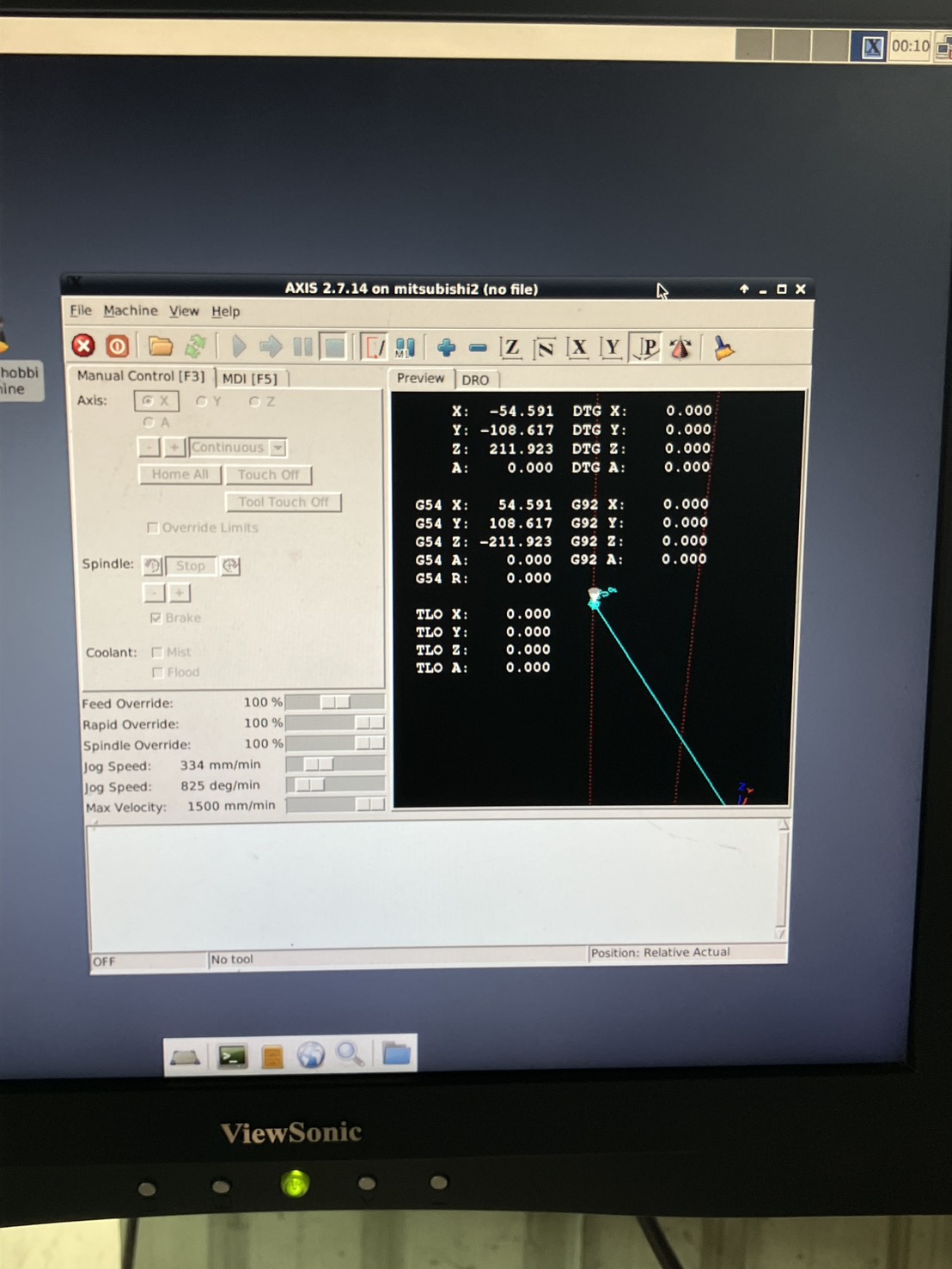

Hello,
I know the following will be somewhat unspecific, but maybe someone has a simple explanation based on my attempt. "Did you try to switch it offandonagain?" Yes already. The machine also seems to move normal, but the Linux desktop cannot be operated normal.
I left the machine on and coming to the workshop today I could not see the Axis window anymore.
The complete desktop behaves strange.
After re-start and unplugging the screen I could start Axis Gui. I cannot move the axis window or re-size it.
Something is odd it seems.
Either something is really damaged on the installation or I have accidently changed some setting that I am not aware of.
Also usually there was a bunch of software things visible and that seems to be missing.

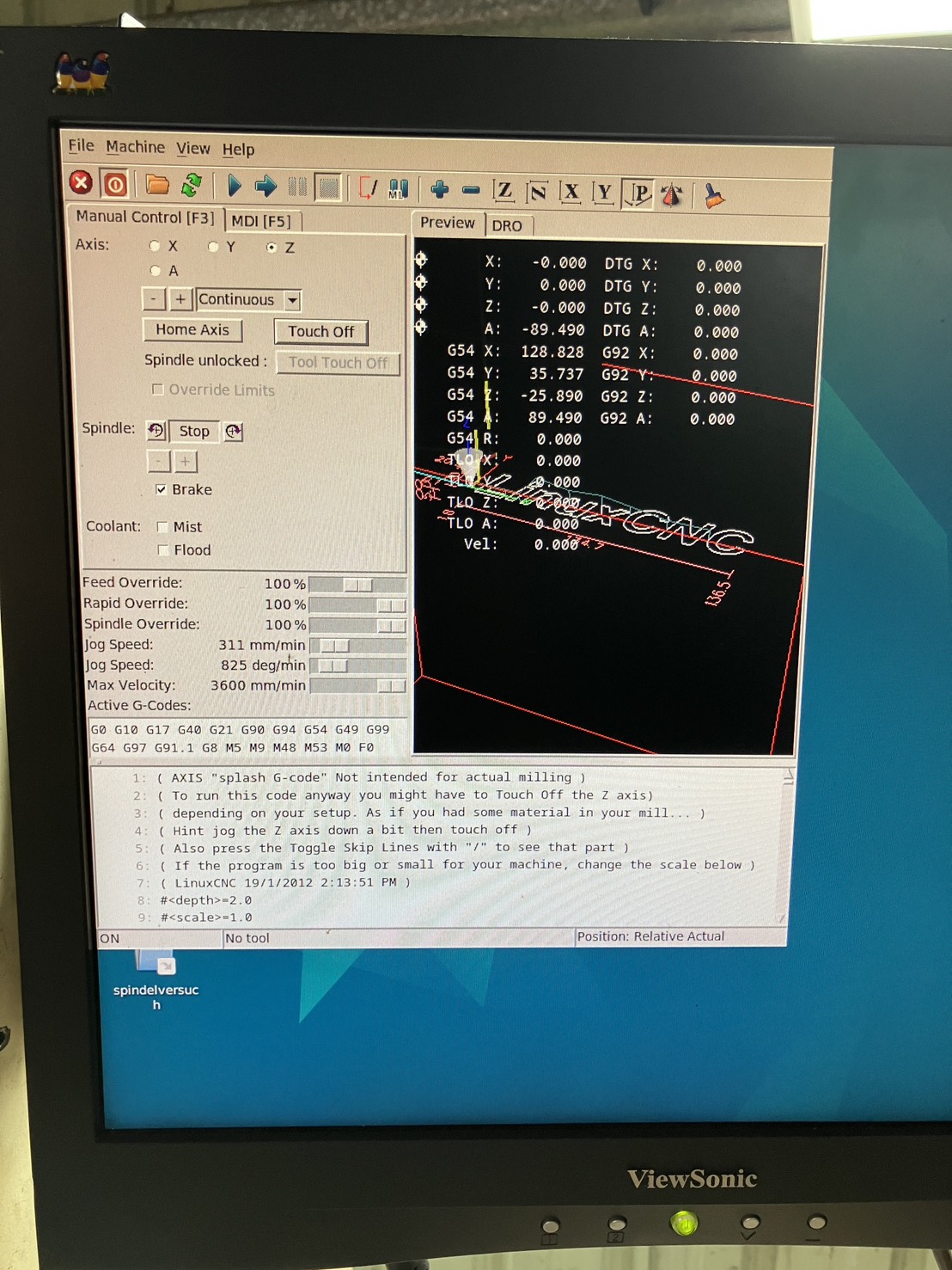

I was clicking more or less randomly. Found an option (which I cannot find again) to choose in a session manager what saved session to start during login.
I deleted that session and now it works again.
I still would be interested to learn what I might have done wrong in the first place.

This happens on my system rarely too, and i can solve it that way:
forum.linuxcnc.org/38-general-linuxcnc-q...-after-reboot#314789
