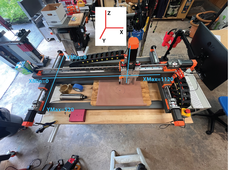

I had to use Claude to help me write the post since i'm new at this so please excuse me, I'm attaching my .ini and .hal files, thanks in advance!!:
Diagnosis: With corrected Fusion360 machine definition (Z up, X right, Y forward), linear motion executes correctly. However, G2 (clockwise) and G3 (counter-clockwise) commands execute in opposite directions.Tested: Triangle draws correctly. Circle with G3 (counter-clockwise) draws clockwise.Question: Is there a XYYZ kinematics setting or HAL configuration that controls arc direction in LinuxCNC?I'm also atteching a picture of my machine:

Actually, i can't get fusions axis to match my machine, if i change the direction of Y (which is the issue right now, either x or Z will also flip)

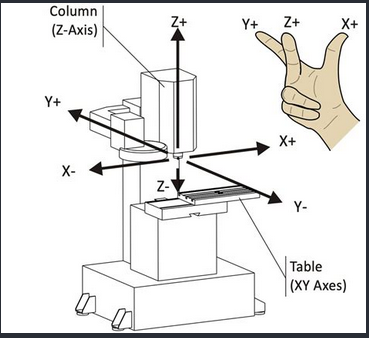

You have setup your machine as a left handed coordinate system instead of the standard right handed system:
Some people get confused by the machine Y only moving in the negative direction from home but that is irrelevant since the actual work is going to be referenced to a work coordinate system (ie G54 ... G59) which can be setup anywhere.
