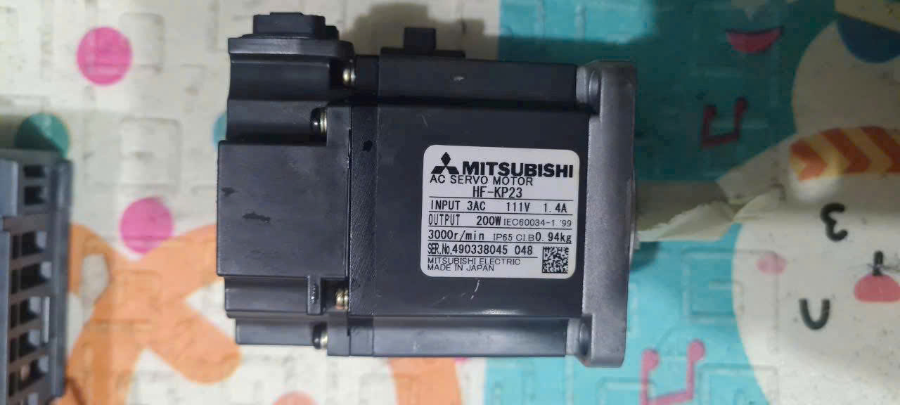

Hi everyone,I am a Master's student currently working on my thesis, which involves designing a custom, low-voltage FOC Servo Driver to control a Mitsubishi MR-J3 motor (equipped with the 18-bit absolute encoder, model J-A22/J-A24).My goal is to achieve full closed-loop control (current, speed, and position) using a custom control board. I am determined to implement the encoder decoder myself rather than using commercial converter modules, as the academic board requires a deep dive into the firmware.What I have done so far:
  1. Hardware Interface: I designed a custom PCB utilizing a high-speed RS-485 transceiver (MAX3485) connected to the USART peripheral of an STM32G4 MCU. The differential lines (MR/MRR) are properly terminated with a 120-ohm resistor.
  2. Signal Capture: I have configured the MCU's USART to run at 2.5 Mbps (8N1), utilizing DMA to handle the high-speed RX buffer without blocking the CPU.
  3. Prior Research: I have deeply analyzed open-source projects like STMBL and various threads on the LinuxCNC forum regarding the "Mit-A/Mit-B" protocols.
The Roadblock: While I can physically capture the serial stream, I am currently struggling with the deterministic behavior of the protocol:
  • The Request Command: I am trying to identify the exact initialization/request byte sequence that the Master needs to send to "wake up" or poll the encoder continuously. I tried sending
    Code:
    0x02
    and
    Code:
    0x1A
    based on some older J2S documentation, but the encoder response is inconsistent.
  • Frame Parsing & CRC: Once the encoder responds, I receive an 7-to-9 byte packet. I am trying to figure out how the 18-bit position data is packed across these bytes (Little-Endian shifting vs. Scrambled bits), and what specific CRC-8 polynomial (and initial value) is used to validate the frame.
I am not looking for ready-made code or copy-paste libraries. I want to understand the underlying data structure and state machine of this specific encoder protocol so I can write my own robust driver.If anyone has any documentation, logic analyzer captures, or insights regarding the J-A22/J-A24 protocol frame format, your guidance would be an absolute lifesaver for my thesis progress.Thank you so much for your time and expertise!Best regards,
lap
 Master's Student in Mechatronics Engineering
Last edit: 3 months 3 weeks ago by vanlap02.
3 months 3 weeks ago #347686 by dm17ry
i believe all amps start with 0x92, then 0x7a, then you can continuously poll it with 0xa2. the answer to 0xa2 is straight-forward:
int16_t abs1 = rxbuf[5] + (rxbuf[6]<<8);
uint32_t cyc1 = rxbuf[2] + (rxbuf[3]<<8) + (rxbuf[4]<<16);
abs1 is full rotations counter, cyc if within-rotation position. afair, it is left-justified to 20 bits, so with your OBA18 encoder 2 LSBs may be always 0.
the last byte of a frame is a xor checksum, not a CRC
The following user(s) said Thank You: NWE

I've made my own motordrive and used the Mitubishi encoders extensively.
I have tested several motors, from the MR-PQ, MR-MFS, MR_SFS and MR-KP
series. They all seem to use the same protocol and checksum. Some types
use full-duplex communication and others use a single bi-directional
version.
From what I have seen, it is important to poll the motor at a fixed
frequency of 4.5kHz.
My source code is available at:
github.com/mark-v-d/motor_control/blob/h...4400/src/encoder.cpp
The class mitsubishi_PQ_t is the full-duplex version of the protocol,
and mitsubishi_MFS13_t is the half-duplex implementation.
Basically start sending 0x1a at 2.5Mb/s at 4.5kHz and the encoder starts
responding. There is a checksum at the end of the packet.

i believe all non-cnc encoders (OSA/OBA 14,17,18,24) answer on both MR and MD pairs simultaneously. OSA253/104/105 only answer on MD so you need to use 4 wire connection with them.
