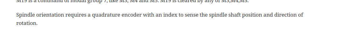

I've not used M19 but it looks like the orient component does not use index at all.
Though M19 does use index:
"Spindle orientation requires a quadrature encoder with an index to sense the spindle shaft position and direction of rotation."
So I would expect spindle.0.index-enable to be set true at some point.

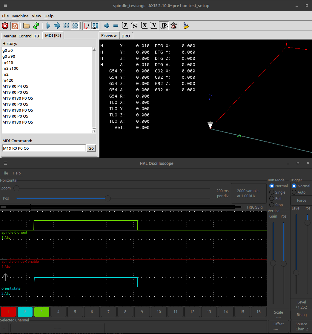

05 Aug 2026 03:07 - 05 Aug 2026 06:07 #348458 by Aciera
linuxcnc.org/docs/devel/html/en/gcode/m-code.html#mcode:m19
I don't think that is correct.  'M19' does NOT seem to set 'spindle.n.index-enable'.
Testesd on real hardware using current master version :
Last edit: 05 Aug 2026 06:07 by Aciera.
