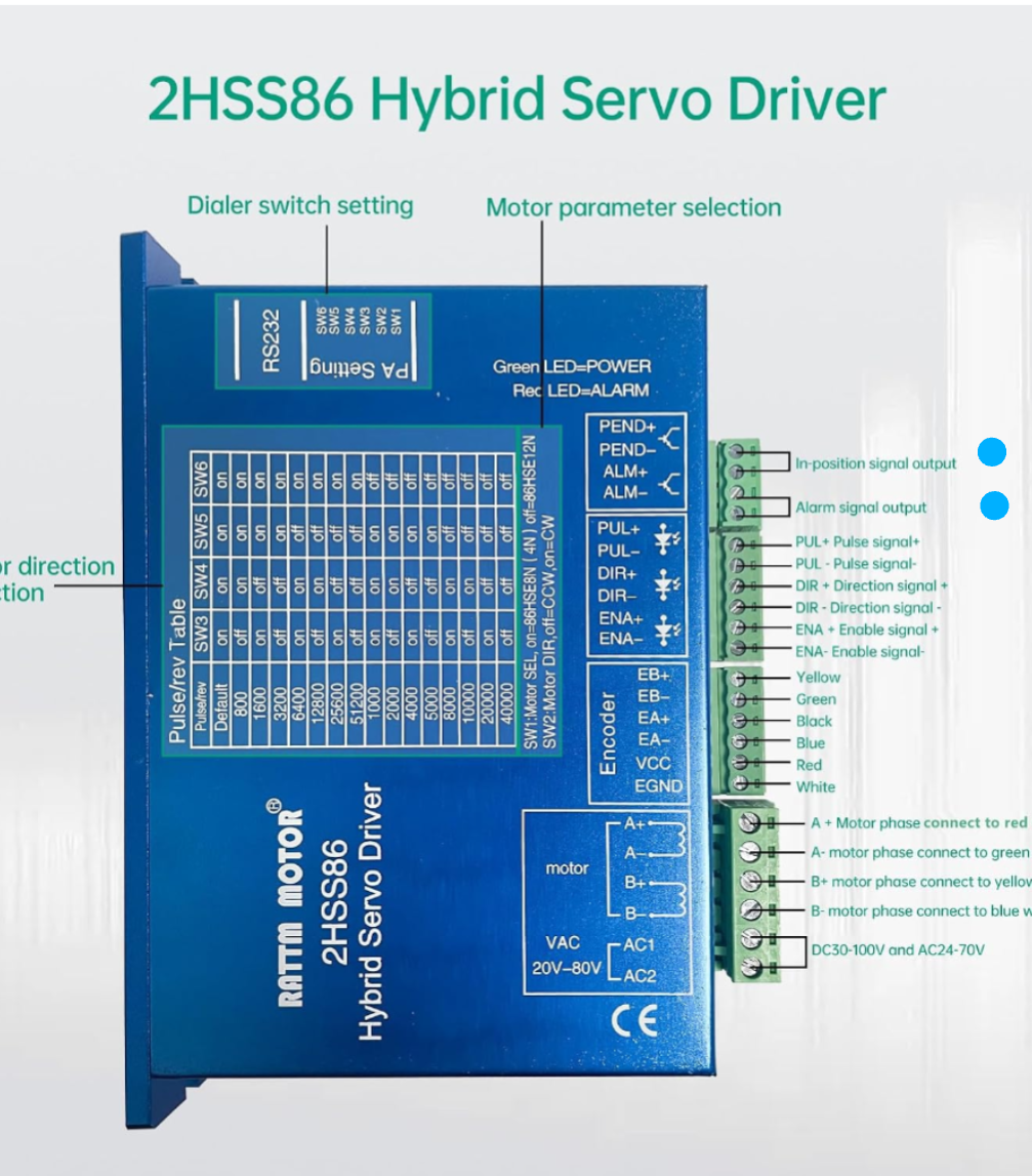

2HSS86 Hybrid Servo Driver wiring
- aabtech
- Posts: 114
- Thank you received: 16
20 Sep 2026 00:12 #349748
by aabtech
2HSS86 Hybrid Servo Driver wiring was created by aabtech

Replied by tuxcnc on topic 2HSS86 Hybrid Servo Driver wiring
These are the pins of the optocoupler output transistors and they can be connected quite freely, as long as something limits the current to a safe value.
You can connect the "-" outputs to ground and the "+" outputs to the inputs that respond to a short circuit to ground, or connect the "+" outputs to the plus of the power supply (no more than 24V) and the "-" outputs to the inputs that respond to positive voltage.
Additionally, these outputs can be connected both in series and in parallel.
For example, the outputs of several ALM controllers in parallel (activation of any one will change the state) and PEND in series (activation of all of them will change the state).

Replied by rodw on topic 2HSS86 Hybrid Servo Driver wiring
Connect ALM to joint.N.amp-fault-in
ref: linuxcnc.org/docs/stable/html/man/man9/m....9.html#JOINT%20PINS
