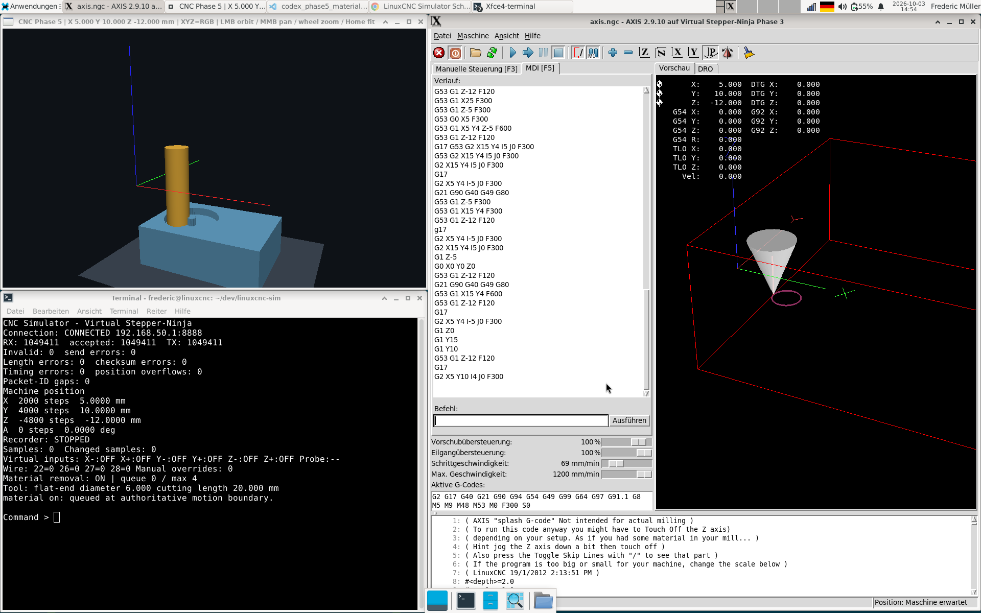

Standalone LinuxCNC machine simulator using the Stepper-Ninja HAL interface was created by fmueller
I've been working on a standalone CNC machine simulator for LinuxCNC and have now published the first experimental version.
The main idea is that the simulator does NOT interpret G-code itself.
LinuxCNC remains responsible for G-code interpretation, trajectory planning, coordinate systems, offsets and compensation. The simulator sits behind LinuxCNC where real motion hardware would normally be connected.
Currently I use the original Stepper-Ninja HAL driver and its UDP protocol as the interface:
The important part of this approach is that the simulator sees the motion that LinuxCNC actually sends to the virtual hardware instead of trying to reproduce LinuxCNC's trajectory planner.
Communication is bidirectional. The simulator can also send virtual machine inputs back to LinuxCNC. I can already use this for limit switches, homing and a simple configurable probe plane.
The current version also contains a sparse voxel workpiece and persistent material removal. Tool movement is processed as continuous swept volumes rather than just removing material at individual sampled positions.
One interesting problem was performance during curved motion. LinuxCNC can generate many small motion segments. Instead of approximating those segments with a larger chord, I batch the actual swept segments for a short time window and calculate the union of their removal volumes. This keeps the resulting voxel state identical while greatly reducing repeated work.
At the moment the simulation is still quite limited:
- flat-end cutter only
- no geometric stock probing yet
- no toolsetter yet
- no spindle/holder model
- no general collision detection
- no rotary material transform
The next area I would like to work on is geometric contact detection. My idea is to use the same contact system later for workpiece probing, a machine-fixed toolsetter and eventually collision detection.
Stepper-Ninja is currently just the interface between LinuxCNC and the simulator. A physical machine does not need to use Stepper-Ninja hardware. I chose it because an existing LinuxCNC HAL driver and a small bidirectional protocol already existed, so I did not have to invent another LinuxCNC hardware interface.
This is my first public release and I consider it experimental development software, not a machine safety system.
Source and v0.1.0:
github.com/FredericM88/linuxcnc-sim
I would be particularly interested in feedback about the architecture. Does placing the simulator behind LinuxCNC at the hardware interface make sense to you? Are there LinuxCNC behaviours or use cases that would be especially useful to test with this approach?

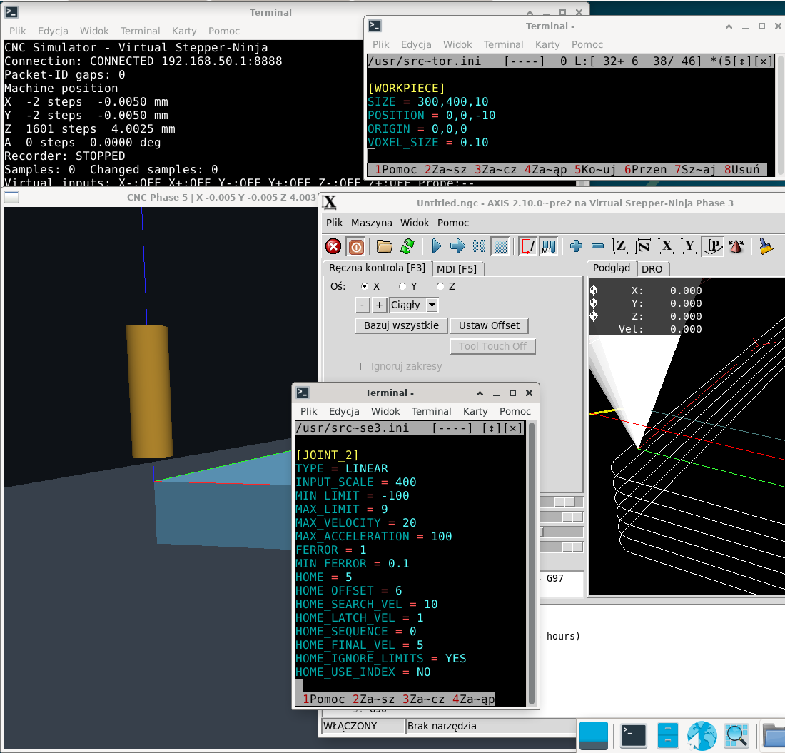

03 Oct 2026 09:32 #350080
by tuxcnc
Replied by tuxcnc on topic Standalone LinuxCNC machine simulator using the Stepper-Ninja HAL interface
Can't compile ninja hal driver for LinuxCNC 2.10, so your hard work is useless for me.

- fmueller
- Posts: 6
- Thank you received: 7
03 Oct 2026 12:20 - 03 Oct 2026 12:32 #350081
by fmueller
Replied by fmueller on topic Standalone LinuxCNC machine simulator using the Stepper-Ninja HAL interface
Thanks for testing it and for posting the compiler output.
Your report exposed an incompatibility between the original Stepper-Ninja HAL driver and the new HAL API used by LinuxCNC 2.10. I have now added a compatibility layer that supports both the LinuxCNC 2.9 HAL API and the new 2.10 HAL API.
I released the fix as v0.1.1:
github.com/FredericM88/linuxcnc-sim/releases/tag/v0.1.1
I did not want to publish the fix based on compilation alone, so I also built LinuxCNC 2.10.0~pre2 as a Run-In-Place installation and tested the driver with HAL API 1.
The 2.10 tests included:
- loading and unloading the Stepper-Ninja HAL module
- the expected HAL pins and data types
- bidirectional UDP communication with the simulator
- homing using the simulated inputs
- XYZ motion
- G38.2 probing using the virtual probe input
- persistent material removal, including curved motion
I also added support for building the HAL module directly against a configured LinuxCNC Run-In-Place tree. The build system still supports installed LinuxCNC development files and keeps the source-only compile-check mode.
For an installed LinuxCNC development environment, the compatibility driver can be built with:
The simulator itself and the Stepper-Ninja UDP protocol were not changed for this fix.
If you have a chance to try v0.1.1 on your LinuxCNC 2.10 installation, I would be very interested in whether it now builds and loads correctly there as well. That would also give me an independent 2.10 test outside my development system.
Thanks again for trying the project so quickly and for providing the error log.

First, a gift - a script that launches both windows with one click.Everything seems to be working, but I found some errors in the settings.
Usually the Z axis looks for the limit switch at the top, here it goes down... You need to change the sign of the HOME_SEARCH_VELOCITY value to the opposite.
The work area is set to extremely small, it is unlikely that the real work will fit. When changing the field, you also need to set virtual limits.
And the worst thing is that I have an offset of several millimeters in the Z axis between Axis and the simulator. I don't know where this comes from. Of course, you can add some value in the material settings, but this is not very elegant.
#!/bin/bash
# change path in next line if needs
cd /usr/src/linuxcnc-sim
./scripts/setup-veth.sh
bash -c 'xfce4-terminal -x ip netns exec cnc-sim-ns runuser -u "$USER" -- env DISPLAY="$DISPLAY" XAUTHORITY="${XAUTHORITY:-$HOME/.Xauthority}" XDG_RUNTIME_DIR="${XDG_RUNTIME_DIR:-/run/user/$(id -u)}" ./build/cnc-sim --config examples/mill/simulator.ini'
linuxcnc examples/phase3/phase3.iniUsually the Z axis looks for the limit switch at the top, here it goes down... You need to change the sign of the HOME_SEARCH_VELOCITY value to the opposite.
The following user(s) said Thank You: fmueller

Thanks for the detailed feedback and also for the launcher script!
We haven't had the opportunity to test your script yet, but we will definitely take a closer look at it. Starting LinuxCNC and the simulator together with a single command is a very useful idea.
I went through the three points you mentioned and used them to update the Phase 3 example.
Working area
You were right that the previous working area was much too small for a realistic milling machine example.
The Phase 3 machine now uses:
The virtual limit switches were updated accordingly and are located 1 mm outside the normal working area.
Z homing
I also changed the Z homing as you suggested.
X and Y still home toward their minimum switches, but Z now homes upward toward the maximum/home switch. The Z switch is therefore approached from below with a positive HOME_SEARCH_VEL.
Z offset between AXIS and the simulator
This was the point I was most interested in, so I tried to reproduce it deliberately.
For the test I placed the physical Z home switch at +1 mm and configured:
This means that the physical switch position is intentionally different from the final G53 Z0 position.
I tested the complete homing sequence with LinuxCNC 2.10.0-pre2.
Z approaches the upper switch from below, backs off, performs the slow latch approach and finally moves back to G53 Z0.
After homing, both AXIS and the simulator showed exactly Z0.
I then commanded:
AXIS showed:
and the simulator showed exactly:
at 400 steps/mm.
I also checked the simulator's min/max switch implementation and added an explicit automated test for approaching the Z maximum switch from below, including its hysteresis behavior.
So far I have not been able to reproduce the several-millimeter Z offset you are seeing.
These changes are now included in v0.1.2:
linuxcnc-sim v0.1.2
The complete simulator test suite also passes with the new configuration: 91/91 tests passed.
Could you try v0.1.2 with the new Phase 3 configuration and see whether the Z offset still occurs on your system?
If the offset is still there, could you send me your LinuxCNC .ini and .hal files, and your virtual-io.conf if you changed it?
Then I can reproduce your exact configuration instead of guessing where the difference comes from.
Thanks again for testing the simulator. Your feedback already resulted in several improvements to the example configuration.

I haven't tested 0.1.2, but I think I found the reason for the zeros moving apart.
In a normal machine, zero is counted from the point where the limit switch is actuated, but here the position of the limit switch is apparently set as relative to zero...
In my settings HOME_OFFSET = 6, so limits set Z max must be 2400 and not 4000 as it was.
After this change, the zeros in both windows are in place.
So there's nothing to fix, but some comment in the virtual-io.conf file would be helpful.

Thank you very much for investigating this further and for explaining what you found.
You are absolutely right.
With 400 steps/mm and HOME_OFFSET = 6, the corresponding physical home-switch position in the simulator is:
With the previous switch position at 4000 steps (10 mm), the difference is:
which explains almost exactly the offset you observed between AXIS and the simulator.
So this is not a problem in the switch implementation. The important point is that the positions in virtual-io.conf describe physical switch positions in the simulator's step coordinate system, while HOME_OFFSET tells LinuxCNC which machine coordinate corresponds to the home-switch position.
I agree completely that this is not explained clearly enough at the moment. A user should not have to discover this relationship by trial and error.
I will add a clear explanation and an example directly to virtual-io.conf and also make sure the documentation describes the relationship between the virtual switch position, steps/mm and HOME_OFFSET.
Thank you for taking the time to investigate this instead of simply reporting that something was wrong. Your observation identified a real weakness in the documentation, and your explanation makes the intended behavior much clearer.
This kind of feedback is extremely valuable for the project. Thank you.
6 mm × 400 steps/mm = 2400 stepsWith the previous switch position at 4000 steps (10 mm), the difference is:
10 mm - 6 mm = 4 mmwhich explains almost exactly the offset you observed between AXIS and the simulator.
