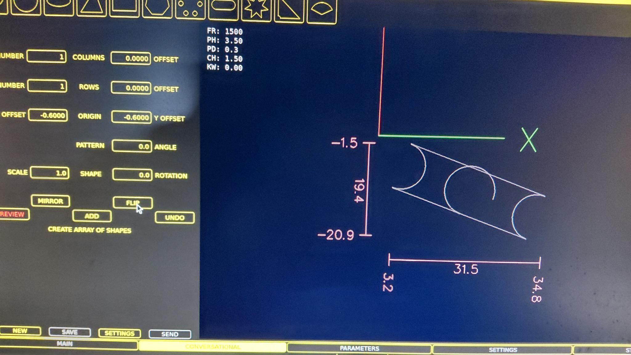

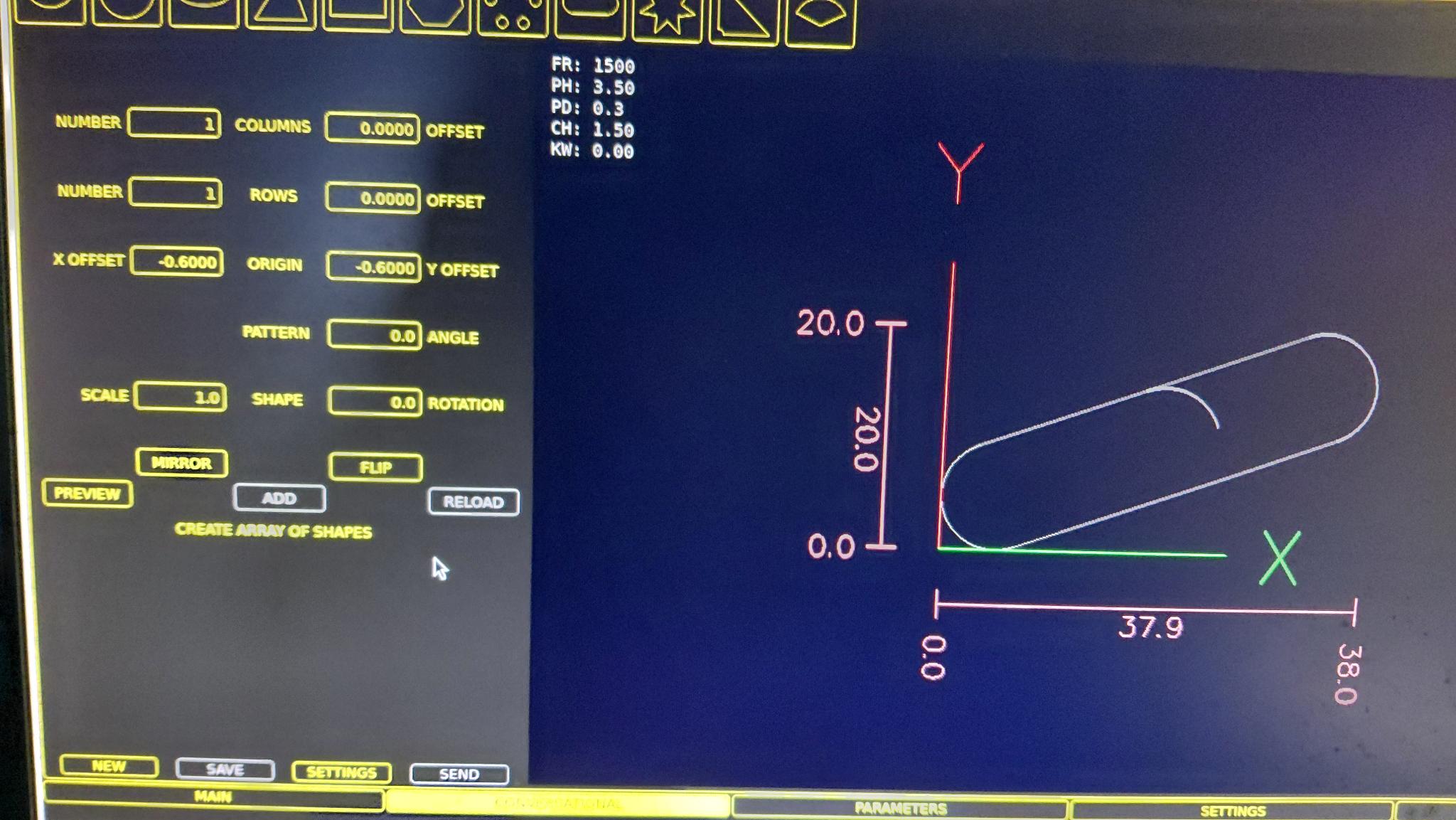

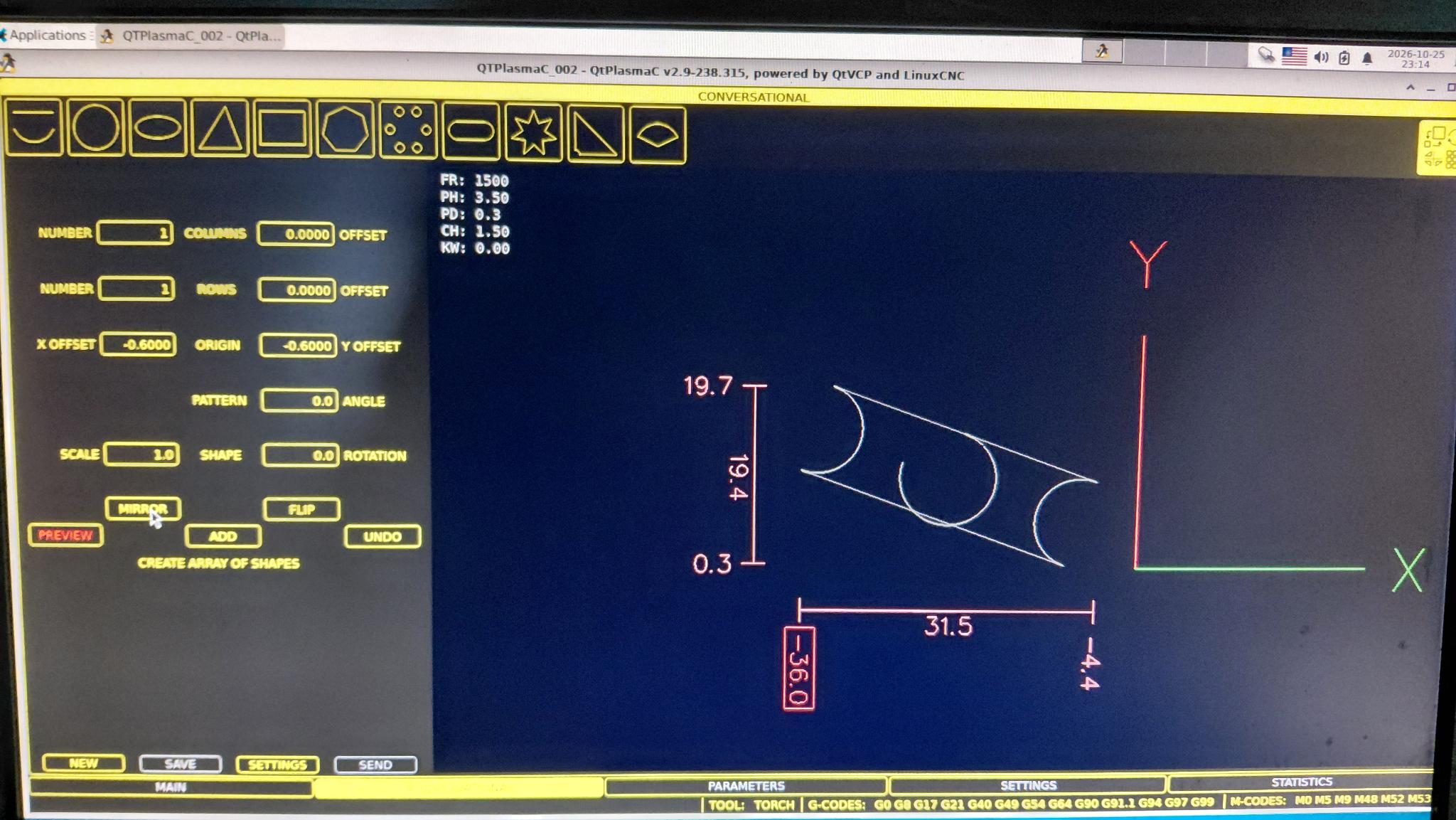

4) AND, I just saw now: is it a flip, is it a mirror?
Original:
Mirrored:
Flipped:
Thanks, for any advice.
