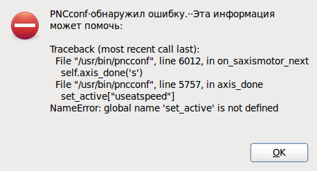

Hi!
One of the users on cnc-club.ru has reported pncconf error.
He was configuring mesa 7i43 and after axis was configured an error was raised on the spindile configuration tab.
It seems like it should be set_active("useatspeed") instead set_active["useatspeed"] at line 5757 and 5754.
EMC verstion is 2.5.
http://cnc-club.ru/forum/download/file.php?id=1608&mode=view

Thank you for bug report. What version of EMC was he using?

2.5.0-pre1-337-g77375f7
you can check the theme translated by google: translate.google.com/translate?js=y&ie=U...%3D1007%26start%3D20
there he have posted detailed procedure of getting the bug.

This should be fixed now. Thanks again for the report.
