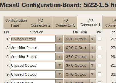

found another glitch also - see the attached screen capture then look into the HAL file - you'll see both drive enable pins have been sent to the same I/O (and that opendrain issue which you know about already)
I'm trying to nut out a drive enable issue in case you're wondering why I had two outputs there ;)

30 Jul 2011 08:20 #12021 by cmorley
try changing the signal name 'enable' to 'xenable' by hand.
The two signals being on the same pin number is an issue without a simple answer.
maybe i should have separate enable output signals for each axis available....
Please post your pncconf file. archive (zip) it first. I'm off to bed will look at it in morning.
