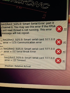

01 Dec 2014 02:12 - 02 Dec 2014 04:27 #53547
by 33zy
Hello,
I am getting some errors at startup, curious if anyone might be able to point me in the correct direction. The error code has good information I do not have the expertise currently to decipher.
I am at the early stages and trying to setup just one axis, could this be a problem in my hal file, or does it sound more like hardware?
I am using the 5v from 5i25
I have 24v field power
(error 1)
hm2/hm2_5i25.0: Smart Serial Error: port 0 channel 0. You may see this error if the FPGA card read thread is not running. This error message will not repeat.
(error 2)
hm2/hm2_5i25.0: Smart serial card 7i77.0.0 error = (13) Communication error
(error 3)
hm2/hm2_5i25.0: Smart serial card 7i77.0.0 error = (3) Timeout
problem resolved:
After using a new cable from the 7i77 to 5i25 these errors ceased. 12/1/2014

01 Dec 2014 02:45 #53549
Replied by PCW on topic Mesa 5i25+7i77 plug-n-go configuration
This suggests a power supply issue of some kind since it looks like communication to the field I/O section
of the 7I77 was lost at startup
I would verify that the 7i77 logic 5V supply is correct (4.5V minimum 5.5V maximum)
The check that the field I/O power is OK (8V minimum 32V maximum <0.5V ripple)
a shorted output and a weak field supply might cause this error also
