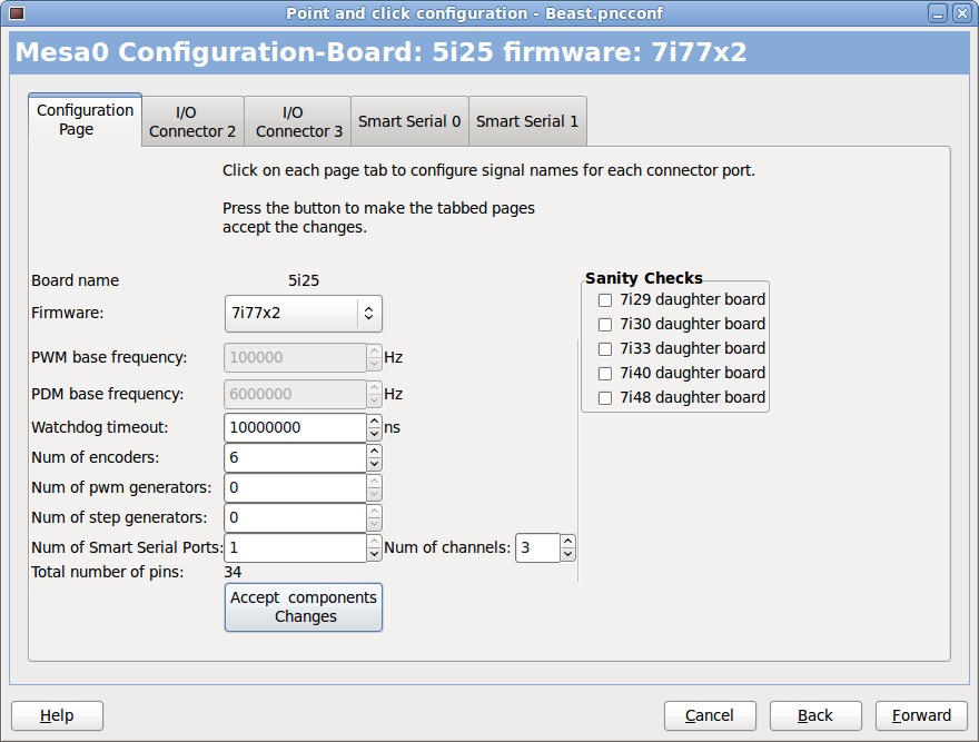

25 Jul 2012 01:43 #22427 by BruceLayne
Replied by BruceLayne on topic Re:5i25 + 7i77 + 7i64
I tried, but the recommended procedure does eliminate the second 7i77, but the 7i64 doesn't show up anywhere in PNCconf that I can see. Here are the various tab screens I get when I set encoders to 6 and sserial channels to 3:
Oops! I can't get this forum to upload images. It worked last night, but tonight all it does is place a blank IMG tag and nothing uploads. I don't have an FTP client on this CNC PC, and don't feel like installing one, so the best I can do is take the screen shot images home and see if I can upload them from there, or put them on my server and provide embedded links. Anyway, trust me, the 7i77 tabs are there (I/O Connector 2, I/O Connector 3, Smart Serial 0, and Smart Serial 1) but there are no tabs for the 7i64.
I thought I had the latest LinuxCNC build, but Update Manager said otherwise. Apparently there was a new build in the last week or so. I used Update Manager to fetch linuxcnc and linuxcnc-doc from buildbot and install it. No good. Same results.
I even pretended like it was a Windows computer and rebooted it. :)
I tried renaming the PNCconf config file with a .bak extension so it would force it to create a new configuration, in case there was something in the existing configuration that was confusing PNCconf, but it still showed the tabs for one 7i77 and no 7i76.
I can Launch Test Panel and it looks like it sees all of the 7i64 and 7i77 pins. Example: hm2_5i25.0.7i62.0.2.adcin.01.in shows up in the HAL Meter as 2.949xxx. The two analog inputs aren't connected to anything and the ADC is sampling noise, so the last three digits are fluctuating. The 00 analog input is 2.944xxx.

/home/beast/Desktop/custom_firmware/firmware.py
Still trying to get the 7i64 to configure in PNCconf. Based on the pins that are available in the Test Panel, it looks like the hardware is being seen, and it's active, but PNCconf won't provide any tabs for the 7i64.
Help me Obi Wan. You're my only hope.

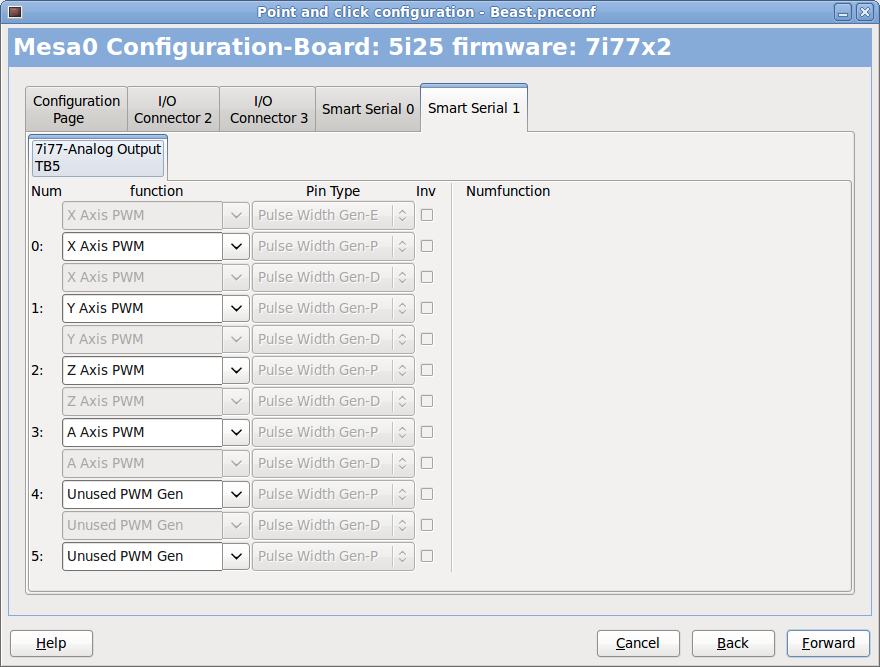

25 Jul 2012 01:45 #22428 by BruceLayne
Looks like the first screen shot went through. Here's a second.

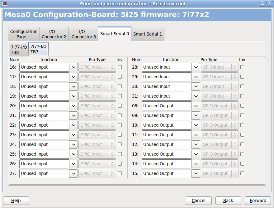

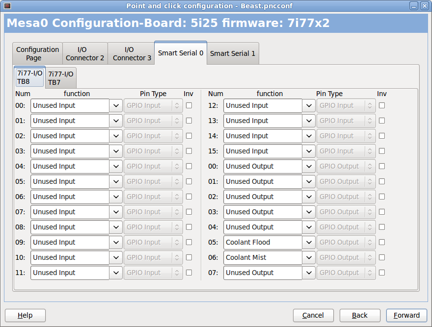

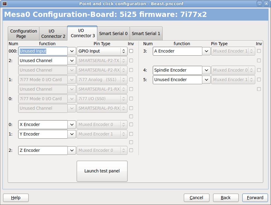

25 Jul 2012 01:46 #22429 by BruceLayne
I can only post one image per post?
25 Jul 2012 01:47 #22430 by BruceLayne
My post count is loving this.
25 Jul 2012 01:47 - 25 Jul 2012 01:51 #22431 by BruceLayne
Almost finished.
Last edit: 25 Jul 2012 01:51 by BruceLayne.
25 Jul 2012 01:49 - 25 Jul 2012 01:51 #22432 by BruceLayne
Last tab screen shot. You should be able to right click and view image to see them full size.
