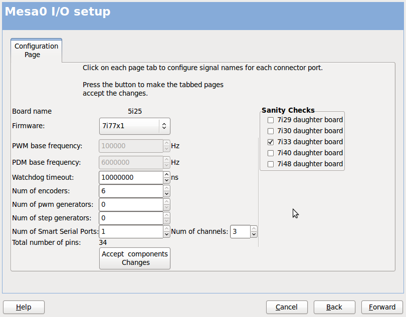

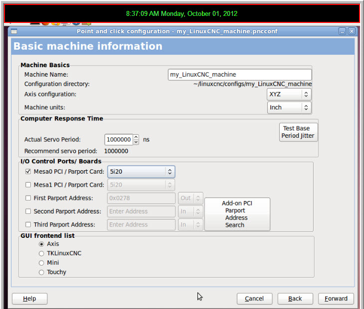

John:
On to what folder should I unzip this?

Do you by any chance also have Mesa sample config for the 7i76?

Piscis wrote:
In your linuxcnc/configs/ directory.
This is my 7i76 copy
John
John:
John

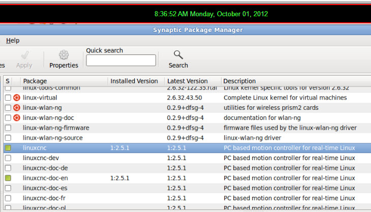

- Piscis
- Posts: 43
01 Oct 2012 22:06 #24839
by Piscis
Replied by Piscis on topic Re:5i25 firmware XML files for PNCconf
- Posts: 7961
- Thank you received: 2162
01 Oct 2012 22:17 #24841
Replied by cmorley on topic Re:5i25 firmware XML files for PNCconf
No the 5i25 does not have a sanity check.
the sanity check is actually just a reminder to set the proper pwm rate.
the 5i25/7i77 does not require a manual setting.
Glad you got it fixed i will add a note to the instructions
