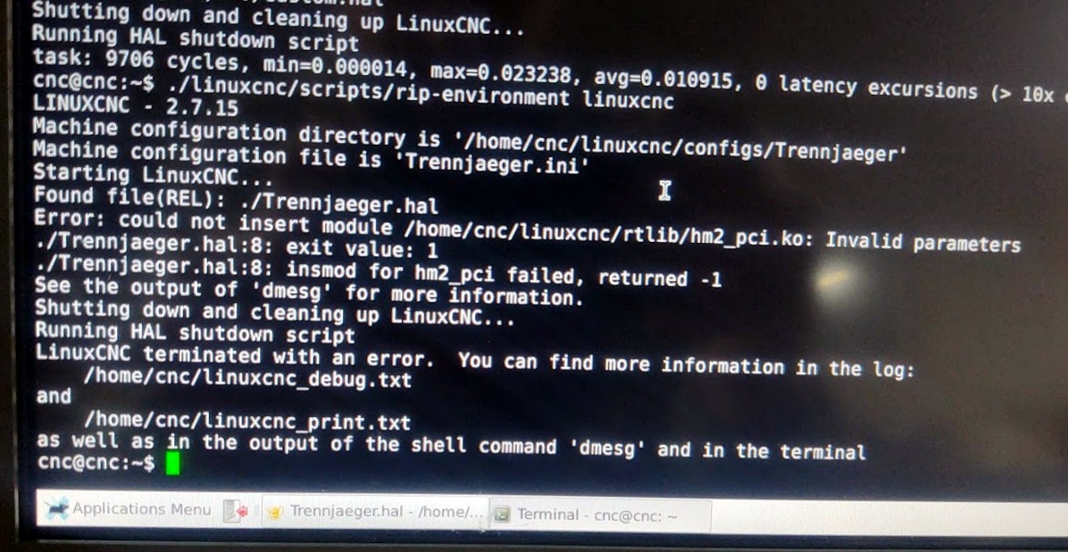

05 Apr 2021 13:47 #204934
by HalaszAttila
Replied by HalaszAttila on topic 7i85s and muxed input encoders
Hello,
one more question about MESA 7i85S.
My configuration is:
5i25 + 7i76 (conn: P3) + 7i84 + 7i85S (conn: P2).
In to FPGA is flashed: 5i25_7i76_7i85s.bit
hm2_pci config=" num_encoders=5 num_pwmgens=1 num_stepgens=5 sserial_port_0=000000"
with this hm2_pci the Linuxcnc config is starts without error, and i can use the 7i85S-s encoder inputs, all 4 works.
My question is how to configure STEP/DIR outputs on 7i85S?
If i incrase the number of stepgens (num_stepgens = 9 => 7i76 (5pcs) + 7i85S (4pcs)) then i have the next error message:
insmod for hm2_pci failed, returned -1
Thanks.
Thanks.
- Posts: 18122
- Thank you received: 5337
05 Apr 2021 14:16 #204938

- HalaszAttila
- Posts: 149
05 Apr 2021 14:38 #204944
by HalaszAttila
Attached the result.
The 5i25 card is about 6-7 years old. If it matters.
The 7i85S is new.

OK that looks right
What is the full error message?
- HalaszAttila
- Posts: 149
05 Apr 2021 14:51 #204946
