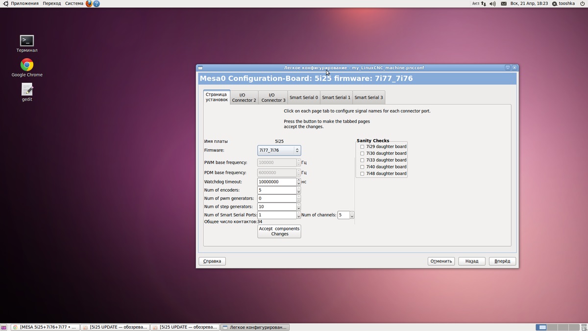

MESA 5i25-7i76+7i77 lack of tabs was created by Wick3

Is this a pic of what you have or what you want?
This pic is correct.

Replied by cmorley on topic MESA 5i25-7i76+7i77 lack of tabs
If that's not what you have, what version of linuxcnc are you using?

Replied by Wick3 on topic MESA 5i25-7i76+7i77 lack of tabs
Thank you.
Figure that's what I want.
I've already figured out - I had version LinuxCNC 2.5.0, half an hour ago updated 2.5.3 - tabs appear.
