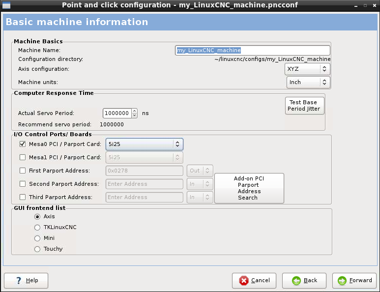

This doesn't work somehow; I cannot select the Mesa card, the box is grayed out:

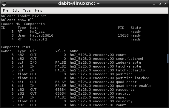

The Mesa card is there though, and recognised:

I had the XML files both in /lib/firmware/hm2 and /lib/firmware/hm2/5i25 (but not at the same time). The 5i25 UPDATE script copies the files in /lib/firmware/hm2 while your instructions say /lib/firmware/hm2/5i25. Doesn't make a difference.
It seems to have something to do with the master-rt. A GIT pull/build (git clone git://git.linuxcnc.org/git/linuxcnc.git) seems to work:
