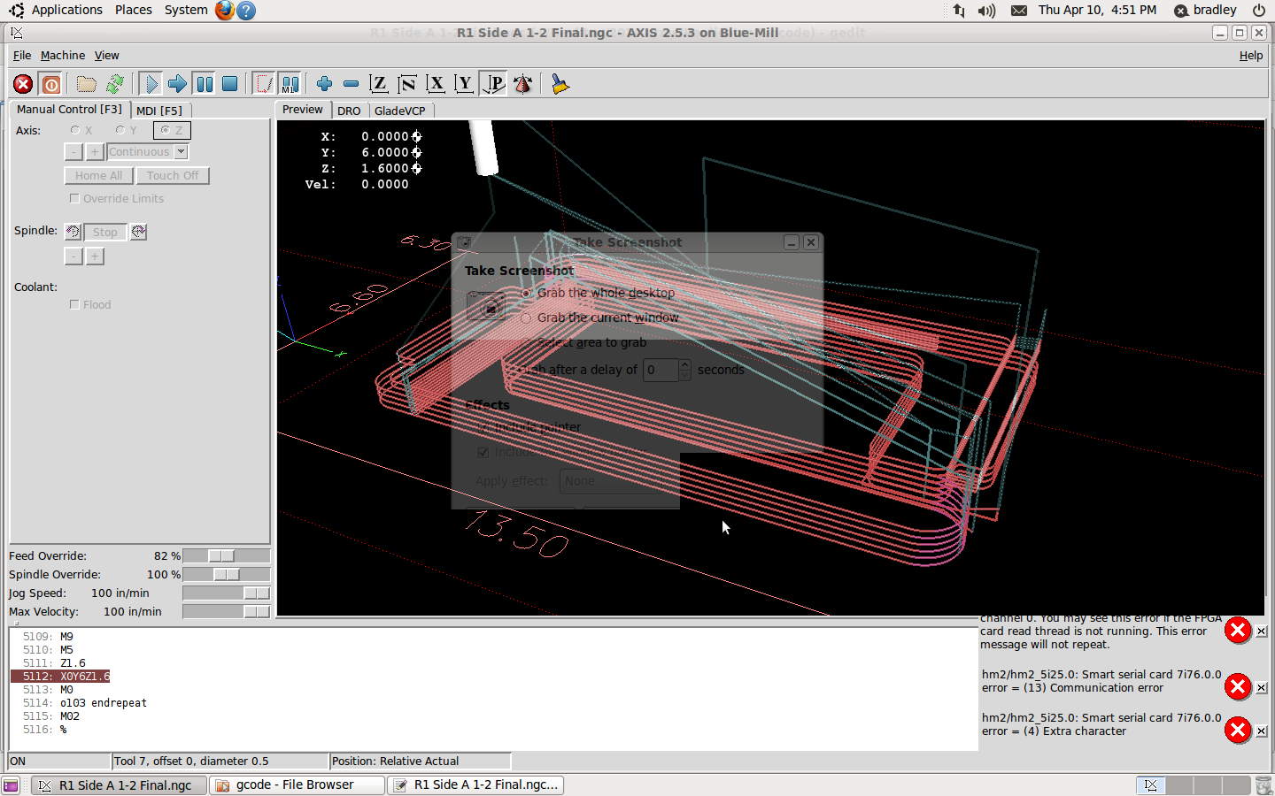

I'm getting some odd errors on my good mill. I'm getting random comm errors with the 7i76. The machine appears to be functioning normally. This may be related...I'm also getting run time errors sometimes which I'm also trying to sort out. I've attached a screen shot of the comms error. Ideas?

These sorts of errors indicate an electrical noise problem.
It may be they you have noise coupled into the DB25 cable with nearby power cables,
or there is a ground loop so enough HF noise current is being conducted via the DB25
ground that more than ~1.5V noise is being developed from the 7I76 end to the PC end
of the cable.
For coupled noise the best solution is re-routing cables so the power cables
(especially motor and power line cables to/from VFDs and servo drives) are as
far as possible from signal cables.
For ground loops you need to make sure no large noise sources connect directly
to the 7I76s ground or common pins. Sometimes line filters on VFD power lines
or common mode chokes on the motor leads may be required on large noise generators
like VFDs and servo drives.
Another possible ground loop issue is having the PC ground be connect via a distant (non machine)
ground.
Run time errors are probably unrelated but need to be be investigated
( make sure you capture the error to see how big the timing error is )

VFD manufacturers tend to state that you need an input filter (but they rarely shout about it). Some VFDs have filters built in.
They are not very expensive: www.ebay.com/itm/251503495598
(Just search eBay for "Rasmi", as that is all they seem to make, though other manufacturers exist)
The filter prevents noise from the VFD travelling back into the mains and into other devices.
Be careful if you have RCD devices on the power feed, some of the filters have more earth leakage than the breaker are happy with.

Fantastic. This is definitely something I can look into, diagnose and isolate.
Just for clarification on those RFI filters: it's for mains side, not motor side, correct?

Yes. A common-mode choke on the motor wires close to the VFD can also help, but addresses a different issue.

So, just to update this....
The run time delay was caused by the fglrx driver. Apparently, I installed it when I first installed LinuxCNC on that machine. I don't know why I would have done that.
The comms error was caused by interference by the VFD. The error would usually get triggered when the VFD was stopping. The source of the interference appears to be some foolish ground bonding. I've got some test leads clipped on different spots and I'll leave it like that for a month before I will feel comfortable that it's the sole source of the issue. So far, all signs point to it being the cause. Thanks for the help!
