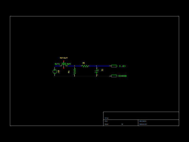

11 Jan 2015 00:07 #54858
Replied by PCW on topic pwm gen 7143 and 7137com
Heres a simple analog output circuit for a 7I37
If you have enough power available, suggest 200 Ohms 1W for R1,
2K Ohms for R2 and maybe 100 uF for C1
- andradela
- Posts: 114
11 Jan 2015 01:23 #54862
by andradela
Replied by andradela on topic pwm gen 7143 and 7137com
Thank you i will test and let tou know the results.
