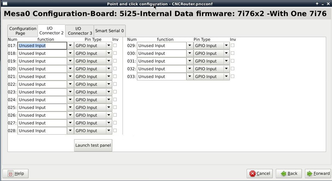

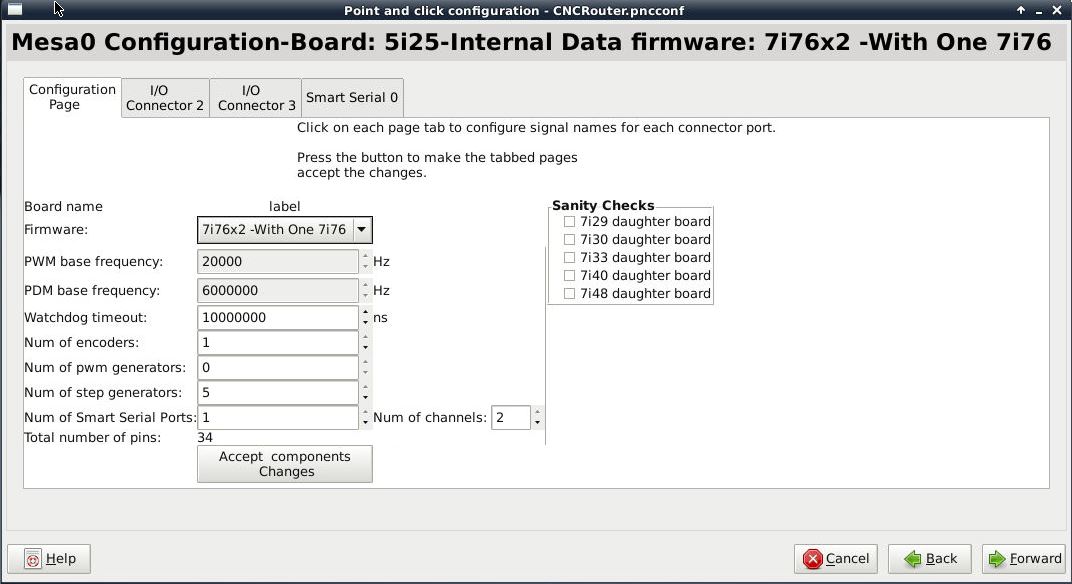

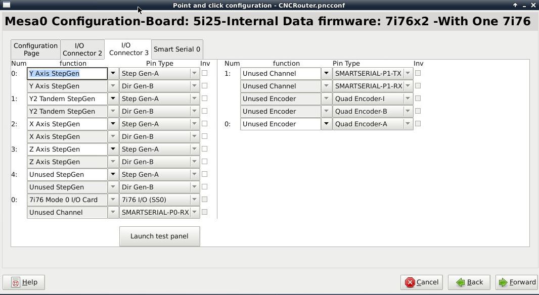

I am trying to set up a new system using the Mesa 5i25 along with a 7i76 (just one). I previously used the parallel port so this is quite a bit different. I went through the point and click configuration and am unable to get any movement on the motors. I am a bit curious if I may have misunderstood the IO configuration pages. The tabs are labled I/O Connector 2 and I/O connector 3. I assume these refer to TB2 and TB3. On each tab is a column labeled "Num" which I assumed was the pin number. What makes this confusing is that the pin numbers don't match the I/O connectors nor the function sets. For example, I/O connector 2 has no options for step and direction in the software and the pin number 25-33 shown in the software is invalid. I have attached the screenshots if that helps.
One other item that isn't clear to me. I am supplying 5V from the 5i25. I have nothing hooked up to the field power right now but I am also not making use of any I/O other than the step and direction. Is this ok? I just assume it is but...
Other than that, it seems to recognize the card, my LED (CR1) is lit. My amplifier is working (using leadshine tuning software). Just seems to be something minor with my configuration.

I went back and selected a different firmware. This time I selected 7i77_7i76. I don't understand how this is different from the 7i76x2 - With One 7i76, but it gets me I/O connector tabs which look much closer to what I expect. I went through and re-configured with this setup but no change.... still can't get any movement. Still lost.

For a 5i25 you must use the firmware that it is already programmed with.
The numbers are _not_ the physical pin numbers but are the component numbers.
You must look in the Mesa 5i25 manual to convert them.

I also don't see these component numbers in the 5i25 manual. I understand now that connector 2 and 3 is referenced to the 5i25 and not the 7i76. I do see the "FUNCTION" from the manual seems to jive with "NUM" on the I/O Connector 2 tab. However, I don't see how the "NUM" on the I/O Connector 3 tab meshes with anything for P3 in the 5i25 manual. Regardless, I feel more comfortable with my settings as they were in my screen shots now.... then again, I would expect something to move.
I loaded up LinuxCNC with the settings as I have them shown and I jogged around while having the meter hooked up to the DIR pins on the 7i76. I expected to see the signal invert when reversing directions on that axis but I do not. Executing dmsg yields the following:

This looks like what I expect it to look like so I think I have actually configured this correctly. However, I am not getting any movement.
