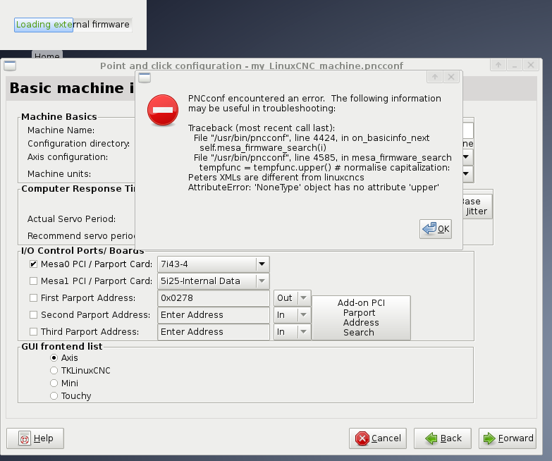

I made the 7i43 bitfile for my configuration:
- 7i47 on P4
- 7i44 on P3 (7i73 and 7i48)
I modified a sample .hal file created with pncconf to load the correct bitfile and it worked and also recognized the 7i73.
Now, I'm trying to load the related xml file in pncconf to try to use it to configure all the pins.
This is what I did:
Downloaded the latest version of mesaflash
github.com/micges/mesaflash (please confirm this is the right place)
Compiled the source from github.com/micges/mesaflash/archive/master.zip
and I created the the xml file:
./mesaflash-master/mesaflash --device 7i43 --epp --readhmid --xml > /lib/firmware/hm2/7i43-4/7I47_7I44.xml
Now when I select the 7i43-4 from pnccof I get this error
I think the bitfile is OK (bitfile, vhd file, readhmid and xml file attached)
Maybe something else to configure?

unfortunately it seems the XMLs that measflash produce are not compatible with PNCconf
