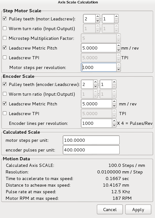

i have servos with 2500 lines encoders 3000rpm that accept step-dir signals.
I plan to use then with step-dir in closed loop with feedback to linuxcnc.
In option motor steps per revolution pncconf accepts maximum 1000 but my servos need 2500 steps/revolution
Any solution for this ?
14 Jun 2015 05:15 #59790 by cmorley
Replied by cmorley on topic pncconf & motor steps per revolution
try setting the micro steps to 10 and the motor steps to 250
250 X 10 = 2500 steps so that should do it
