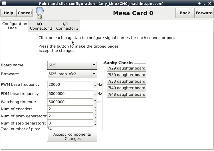

Good evening gentlemen.
I am one of those guys that is venturing over to linuxcnc from Mach3. Linux is new to me so please be gentle.
I need help! I am trying to setup a Mesa 6i25 card with a C32 BOB from CNC4PC . Unfortunately when I go thru the PNCconf wizard and select the prob_rfx2 firmware the pins don't look correct.
So I decided to go to Mesa website and download the configurations for the Mesa card.
Question 1: What directory do I have to put in the new configurations?
Question 2: Would there be a specific way on copying the files over to that directory?

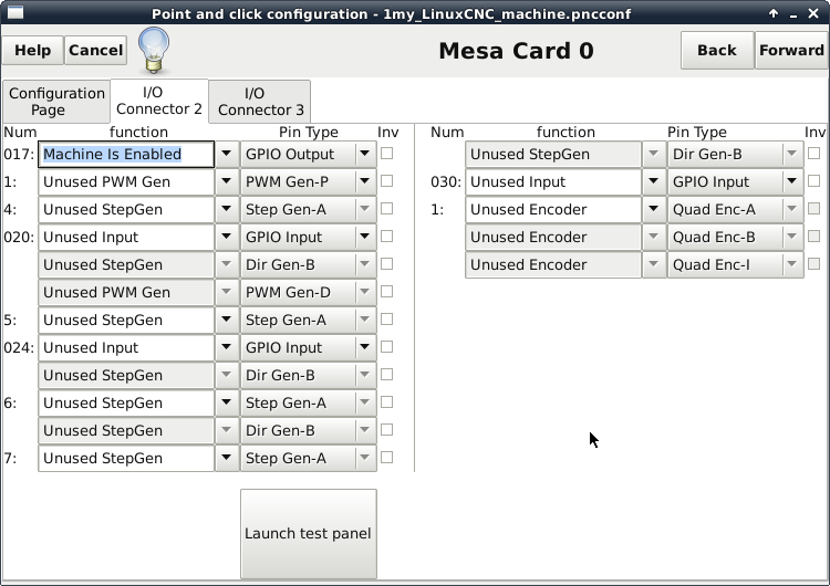

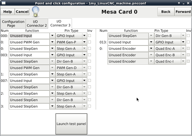

Ok I looked at the pin assignments for the probfrx2 file and I think this is the closes pin assignments for my needs.
So i flashed the Mesa card with the probfrx2 bit file.
When I run PCNconfig and select the bit file on the firmware the pins dont seem to match.
What am I doing wrong?
I have attached some screen shots.

At this point I would probably just try the config as-is
and make any needed changes to the hal and ini files
