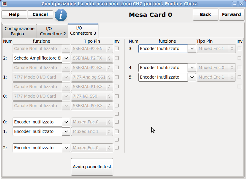

UBUNTU10.04 LINUXCNC2.7 pncconfig was created by bkt
anyone using ubuntu10.04 linuxcnc 2.7 pncconfig 5i25 and 7i77 with succes?.... in me case I can't use pnncconfin that not show all configuation page ....My suspect is that.... when update from 2.6 to 2.7 not all dependecy needed update with linuxcnc 2.7 and sometings go aout...... someone knows how dependacy are important to check?

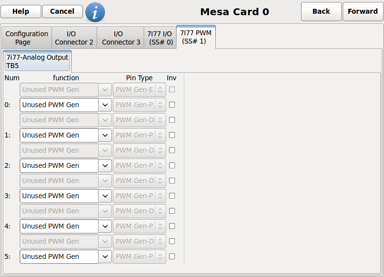

I just updated a test machine (a Intel D525) running Ubuntu10.04 from 2.5.4 to 2.7
I used these instructions:
linuxcnc.org/docs/devel/html/getting-sta...l#_updating_linuxcnc
pncconf works as expected
That is, when I select internal 5i25 config and 7i77x2 with one 7I77,
as soon as I press the accept changes button, a 7I77 I/O and a 7I77 PWM tab appear
the 7I77 I/O tab has the TB7 and TB8 I/O and the 7I77 PWM tab has the TB5 I/O:

Nothing to do .....
today I downloaded new iso ubuntu10.04 + linuxcnc2.5 .... verify with md5sum (ok) ... installed ... run stepconf 1 time with parallel port ok! Using software source and synaptic I upgrade to 2.6.10 ... re.run the pc.... run stepconf 1 time with parallel port ok! ... re.run the pc ....Using software source and synaptic I upgrade to 2.7.1 ....re.run the pc.... run stepconf 1 time with parallel port ok! ... run PnConfig ... the same NOT APPEAR TB5 CONNECTOR ....
Than I downloaded 5i25.zip from this store.mesanet.com/index.php?route=product/product&product_id=55 ... wit sudo nautilus I've create 5i25 folder in /lib/firmware/hm2 with only 5i25_7i77x2.xml and .pin file .... sudo apt-get install mesaflash ....
sudo mesaflash --device 5i25 --write /home/k1/5i25/configs/hostmot2/5i25_7i77x2.bit
sudo mesaflash --device 5i25 --reload
sudo mesaflash --device 5i25 --verify /home/k1/5i25/configs/hostmot2/5i25_7i77x2.bit
all ok ...... try launch pnconfig again whit 5i25 selection .... only 7i77x2 config is possible .... accept ...same result not ss0 and ss1 windows.

did you press the accept changes button , after selection ?

@ cncbasher .... why? in your release i/o connect2 and i/o connector3 appear without press the accept change button? .... in mine isn't possible ... I must press the button!!!
