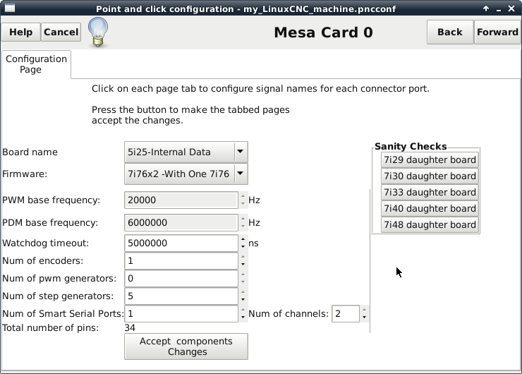

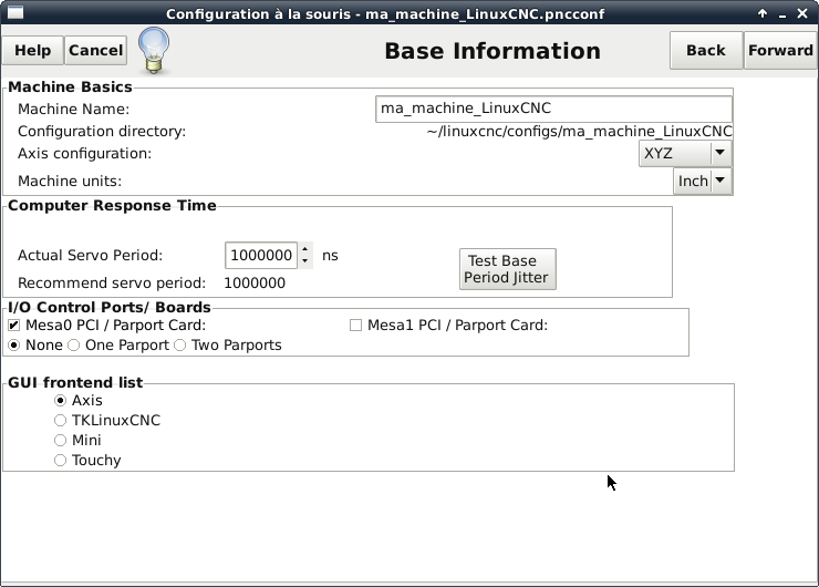

Cannot select 5i23 Mesa card in PnCConf
31 Jan 2016 05:07 #69307 by laurentl38
Cannot select 5i23 Mesa card in PnCConf was created by laurentl38

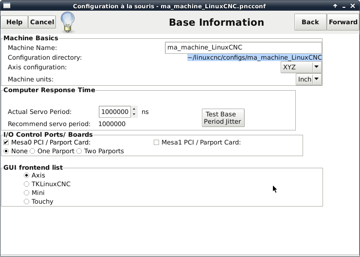

Hi

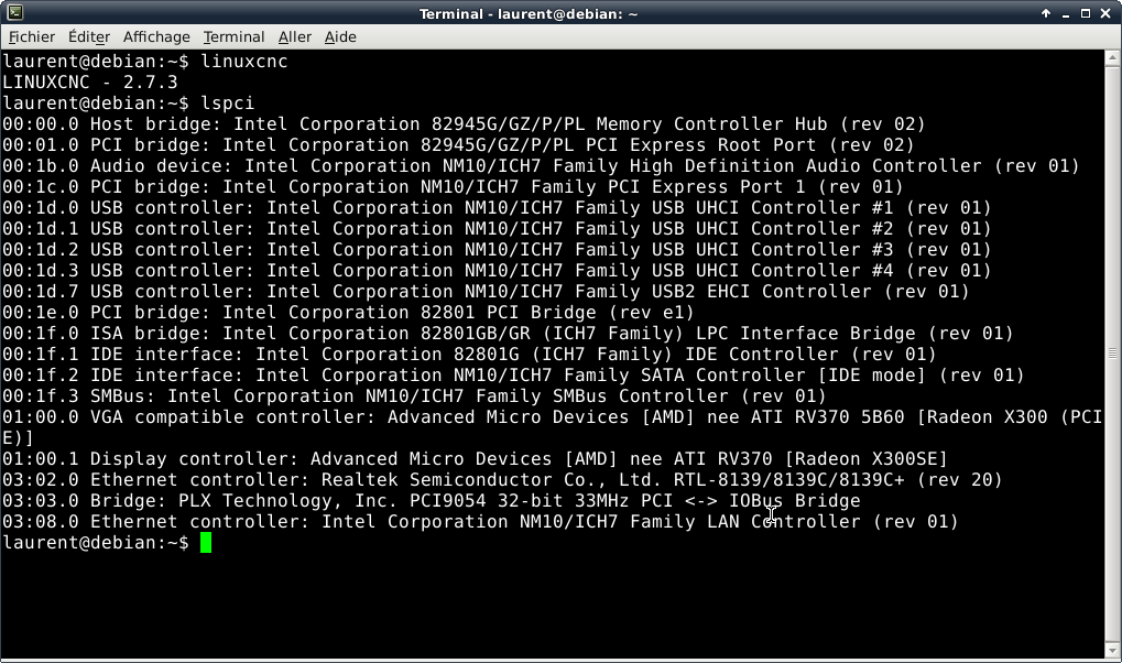

I buy 5i23 7i48 and 7i37 combo, and I started building a new PC for LinuxCNC (2.7.3).
In first time, i installed only Mesa 5i23 and i not connected the other card. But when stard PnCConf, I can't select the Mesa ca
If i made lspci, i think the card is detected at 03:03.00

I see there have a possibility to flash firmware of the 5i23, but I'm not really understand the cyle to make it ...
What's next? How do I solve this?

31 Jan 2016 13:25 - 31 Jan 2016 13:25 #69329 by andypugh
Replied by andypugh on topic Cannot select 5i23 Mesa card in PnCConf

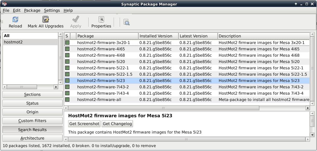

The 5i23 is one of the older-style cards that loads the firmware at every boot.
The first thing to check is that you have the hostmot2-firmware package:
If you have, then your little test script needs to look like
halrun
loadrt hostmot2
loadrt hm2_pci config="firmware=/hm2/5i23/SVST4_8.BIT"
show pin

31 Jan 2016 21:42 - 31 Jan 2016 21:51 #69358 by laurentl38
Replied by laurentl38 on topic Cannot select 5i23 Mesa card in PnCConf
hi,
Thank you, for your reply. I check the package, and i have well the last version of hostmot2-firmware-5i23
I just test your test script and the result is :
laurent@debian:~$ halrun
halcmd: loadrt hostmot2
halcmd: loadrt hm2_pci config="firmware=/hm2/5i23/SVST4_8.BIT"
halcmd: show pin

I start pncconfig, but there are same result, i can't select Mesa card

is it normaly ?

31 Jan 2016 21:54 #69360 by cmorley
Replied by cmorley on topic Cannot select 5i23 Mesa card in PnCConf
you select the card type and fimware type on the mesa page of pncconf.
Have you done this ? can you see the card and firmware?
did you push 'accept component changes' button?
Chris M
31 Jan 2016 22:07 #69362 by laurentl38

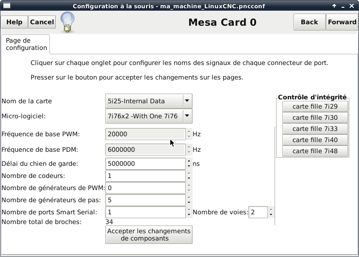

When start pncconfig in the page, i can't select mesacard. is it normaly ?
After, on this page, i can select 5i23 et svst4_8. if i push 'accept component changes'. there are no error message.
01 Feb 2016 02:41 #69366 by cmorley
ahh yes there is a translation error. it should work properly in english.
If english is on your system you can start pncconf in a terminal in english with something like:
LC_ALL=en_CA.utf8 pncconf
the command:
locale -a
should show the available locales.
Chris M
01 Feb 2016 13:29 #69382 by laurentl38

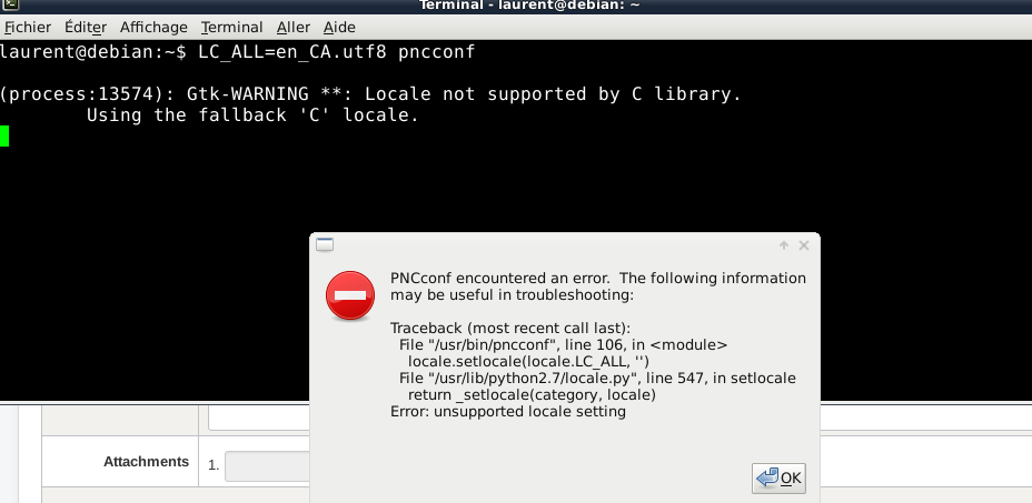

i 'm not very lucky ...
when i start "LC_ALL=en_CA.utf8 pncconf" i have this error of pncconf
and if made "locale -a" i have
laurent@debian:~$ locale -a
C
C.UTF-8
fr_FR.utf8
POSIX
laurent@debian:~$
01 Feb 2016 13:58 #69383 by cmorley
try :
sudo locale-gen en_CA.utf8
to install an english locale
This was my reference:
makandracards.com/makandra/28205-linux-r...le-than-your-default
Chris M
01 Feb 2016 14:13 #69387 by laurentl38
thanks your for your reply,
i just test locale-gen, but the result is strange !!
I had :
laurent@debian:~$ sudo locale-gen en_CA.utf8
Generating locales (this might take a while)...
fr_FR.UTF-8... done
Generation complete.
laurent@debian:~$
and after, i have the same error result with "LC_ALL=en_CA.utf8 pncconf"
It's strange because if i well understand your link, normaly, i think the result should have been:
en_CA.utf8... done
laurent@debian:~$
01 Feb 2016 15:15 #69396 by laurentl38
i just resolve 1 probleme
i run "sudo dpkg-reconfigure locales" after "sudo locale-gen en_CA.utf8"
And i can run "LC_ALL=en_CA.utf8 pncconf" but i have a warning
bash: avertissement :setlocale : LC_ALL : impossible de changer le paramètre de langue (fr)
but after the problem is the same, i can't select mesa card in this page
but now the text is in english on this page :
