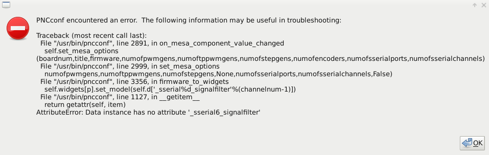

Hello,
I'm having a problem with Pncconf . The linux is freshly downloaded and installed . Since I want to use the 5i25_7i77_7i74 firmware I ran the update script with the necessary files straight from mesa . The card is flashed accordingly . When I have to select the firmware and apply the changes in pncconf it gives an error message .
What's interesting is that halcmd shows the correct pinout of the device .

can you post the XML file - I assume you are using the XML file from MESA?

Thank you for the reply !
Yes, the file is from mesa .
In the end I corrected the files from another machine with a similar setup and it started up .
Should the INT LED on the 5i25 blink?

I believe it blinks at the servo thread rate.
Thanks for the XML I'll try to find out what happened.
Chris M
Chris M

Could you post the file as archived ? i can't use the file format as downloaded.
