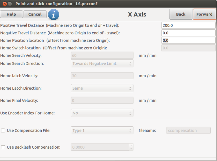

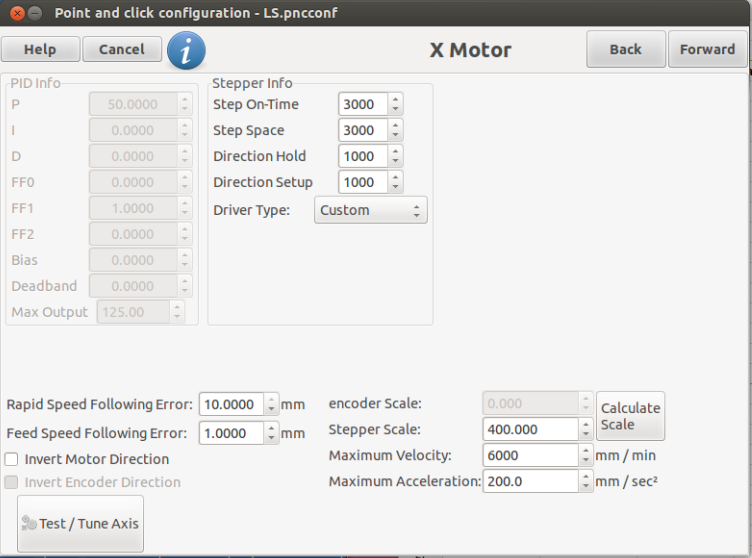

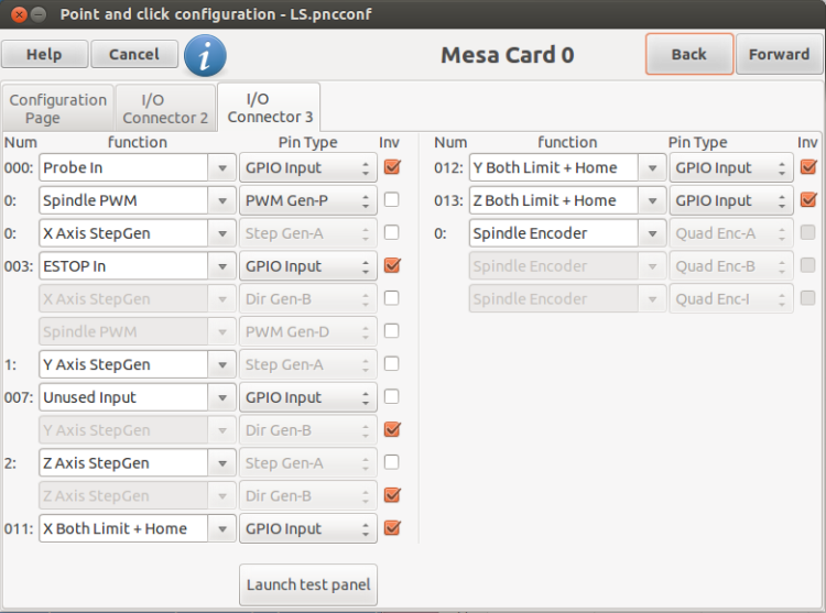

My machine uses it's limit switches for both end-points as well as homing. When I try configuring the X-Axis in pncconf, the Home config fields are grayed out. It only seems to occurs on X axis, Y & Z axis are fine. Please see attached screen captures.
Is there a bug, or have I done something incorrectly?

Replied by cmorley on topic X Both Limit + Home
looks like a bug..i'll look at it thanks.

17 Feb 2016 17:30 #70319
by LS
Replied by LS on topic X Both Limit + Home
Hi Chris,
Do you know if this bug had been resolved in 2.7.4?
Cheers,
Luke
Cheers,
Luke
- Posts: 7368
- Thank you received: 2182
17 Feb 2016 20:01 #70330
no it missed 2.7.4
Chris M
Chris M
- LS
- Posts: 36
19 Feb 2016 09:01 #70371
by LS
Okay no problem.
I've manually edited the config files to get it working for the moment.
