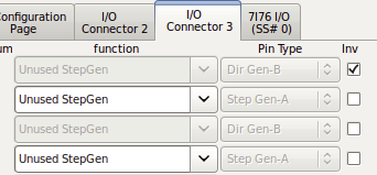

I am new to LinuxCNC, and I am trying to configure all the electronics step by step.
I have a 6i25/7i76 combo connected to Leadshine DM556 drivers in 'differential mode' (Step +/- to Pulse +/-)
It all works well (using the 'Test/Tune Axis' tool), but I was trying to understand if I was triggering on the right edge (step pulse and space have the same duration on these drivers, so either way would probably work).
I started changing the 'Inv' checkbox for Step Gen / Dir Gen; but I could not see any difference -- also measuring the voltage on the board did not show any difference.
When I looked at 'hm2_5i25.0.gpio.000.invert_output'/'hm2_5i25.0.gpio.001.invert_output'' with Hal Meter they were always 'FALSE' regardless of the 'inv' checkbox status
Now when entering the 'Test/Tune Axis' tool, I could see on the console
A quick look at the source showed that we were missing a '\n':
With this quick fix I now have the correct flag in Hal Meter, but I still can't see a real difference in my tests (nor in the board voltages)
Am I doing something wrong here, or is there a better way to test?
(Running LinuxCNC 2.7.3 / Linux 3.16.0-9-rtai-686-pae)

However, I am still a bit confused, and I tested again this evening, re-measuring the voltages on the board.
I do see a change now when I invert, but they invert the wrong signal!
That is: Inverting 'Step Gen' will invert the Dir signal, and the opposite!
When you invert 'Step Gen', you generate 'setp hm2_5i25.0.gpio.000.invert_output true'
When you invert 'Dir Gen', you generate 'setp hm2_5i25.0.gpio.001.invert_output true'
It makes sense at first, but when I look at the 7i76 manual (Page 10) it seems that Dir is mapped on GPIO 0 and Step on GPIO 1
Don't we have the GPIO pin mapping wrong?

FYI, here is what dmesg says:
This confirms that Dir is on GPIO pin 0 and Step on pin 1
An easy fix could be to swap STEPA/STEPB in private_data.py where they are 'assigned' to the board:But that might look a bit strange as it would show 'B' before 'A' in the UI:
We can't just rename the pins ans say 'Dir Gen - A' / 'Step Gen - B', as other part of the code rely on the fact that STEPA is the step gen...

14 Feb 2016 17:59 #70136
Replied by cmorley on topic PnCConf -- Inverting Step Gen / Dir Gen signals
I did in fact just swap the names in the firmware array.
I also took the chance to change the 7i76e firmware - I'm pretty sure it's the same.
Thanks again.
