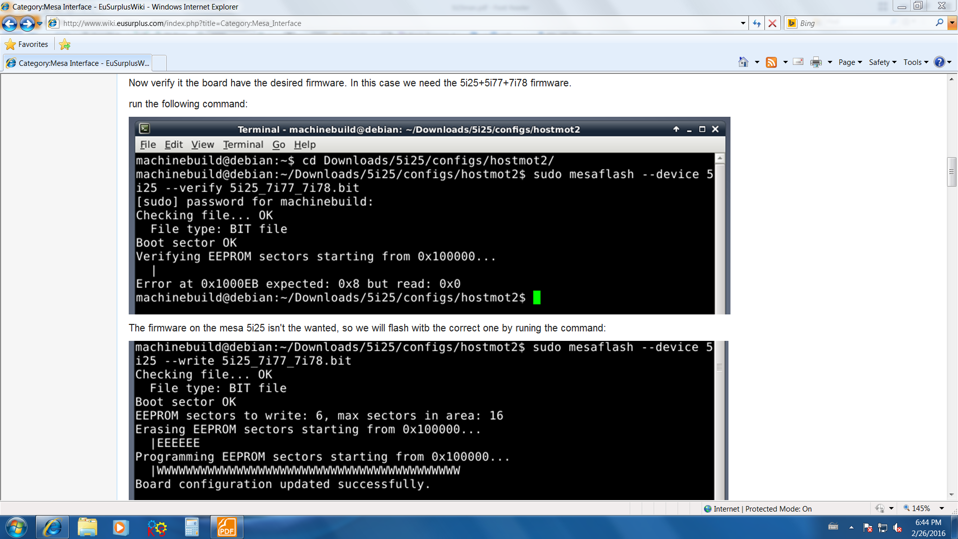

hi im trying to check firmware on my 5125card and7177dautherboard.im frustrated as hell sins i cant find any decent step by step instruktion on the matter other than one on www.wiki.eusurplus.com/index.php?title=Category:Mesa_Interface.
im very new to linux and im obviously doing someting wrong,can firmware be check and installed in any other way than with"terminal window commands??.
i have bougt a 5125 and 7177 card from eusurplus.com ,not a plug and go kit so i think a need to install new firmware.
i have put som additional 5125 folders under the hostmot2 folder that i downloaded from mesas homepage xlm files and .bit .pin etc.
i typed sudo nautilus in terminal window and used tts as password and i got into root.
i have not been able to verify or flash firmware to my 5125card .and i have change permissions under properties on all files and folder under/hostmot2 to "tts"
when atempting to flash firmware into 5125card thru terminal i get "unknown command"
a simple step by step instruction would be appreciated.
also "sudo" is that a run or execute command???.

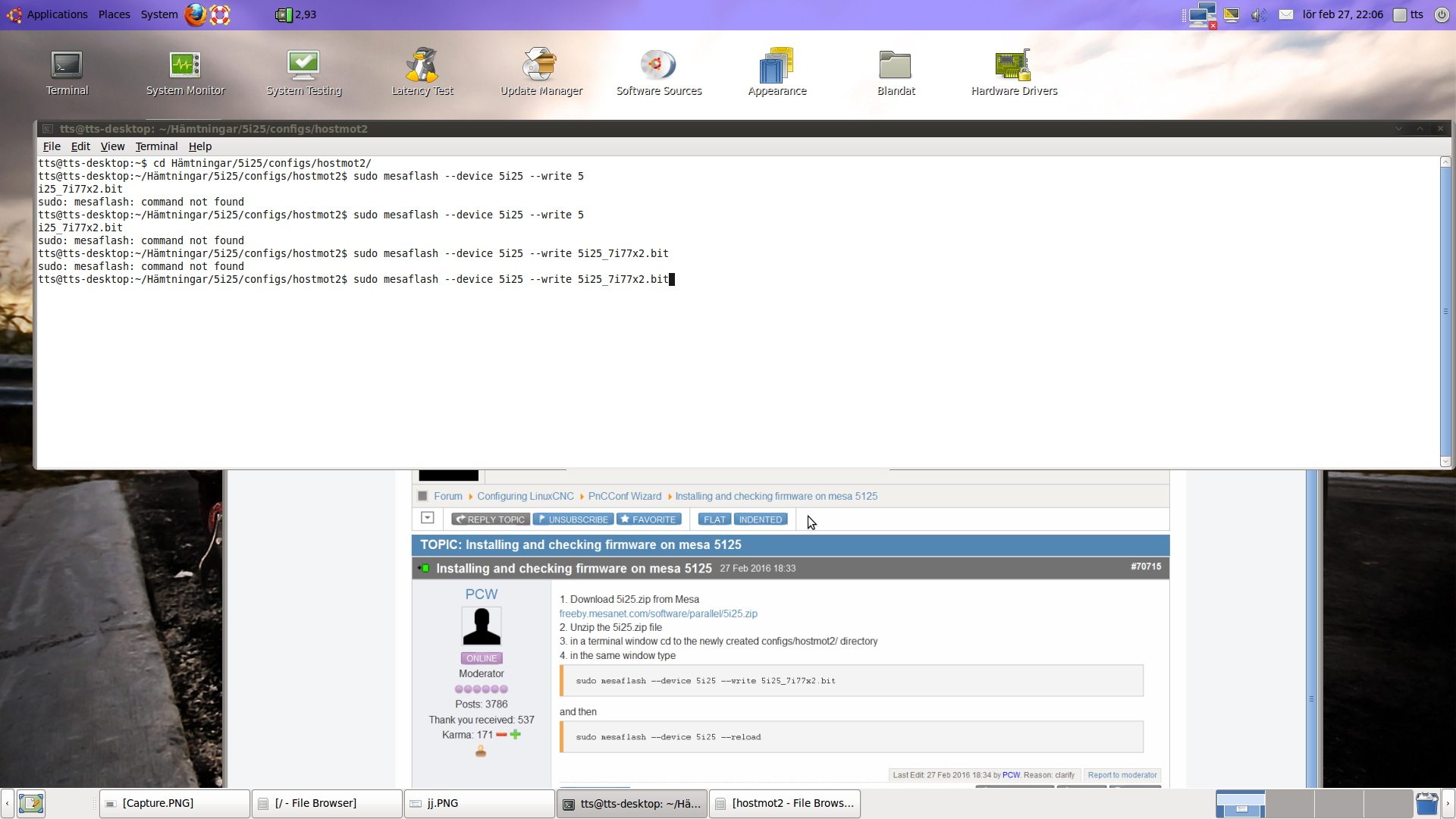

27 Feb 2016 13:06 #70717
by Ncmill.ts
Replied by Ncmill.ts on topic Installing and checking firmware on mesa 5125
this is what i get.
am i typing it wrong or what.
- Posts: 18122
- Thank you received: 5337
27 Feb 2016 13:14 #70718
Replied by PCW on topic Installing and checking firmware on mesa 5125
You need to install mesaflash:
sudo apt-get install mesaflashPlease Log in or Create an account to join the conversation.

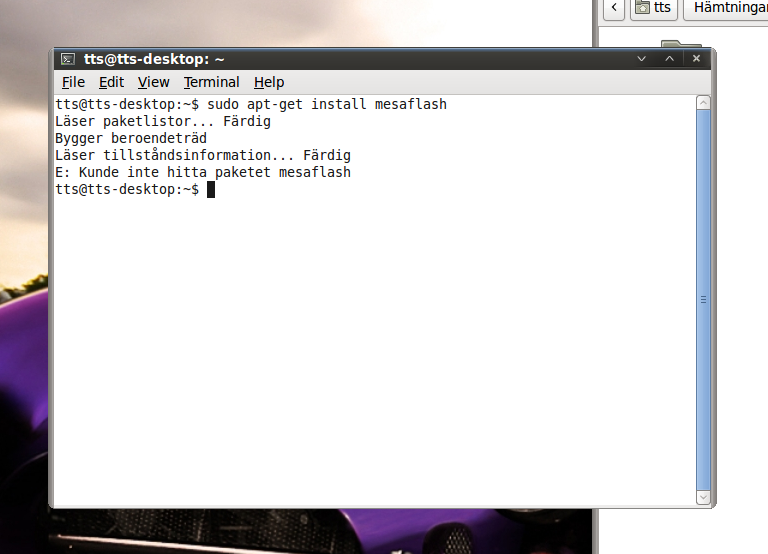

- Ncmill.ts
- Posts: 17
27 Feb 2016 13:35 #70721
by Ncmill.ts
then i get this
some text are in swedish but on line E: it says "E: unable to locate(or find) pakage mesaflash
- Posts: 18122
27 Feb 2016 13:41 - 27 Feb 2016 13:43 #70722
What linuxcnc installation (OS+linuxcnc version) do you have?
the
should work on the stock linuxcnc package
the
Last edit: 27 Feb 2016 13:43 by PCW.
- Ncmill.ts
- Posts: 17
27 Feb 2016 13:46 #70723
by Ncmill.ts
ubuntu 10.04 lts lucid lynx
- Posts: 18122
27 Feb 2016 13:50 #70724
what linuxcnc version?
- Ncmill.ts
- Posts: 17
27 Feb 2016 14:04 #70726
by Ncmill.ts
linuxcnc 2.50
- Posts: 18122
27 Feb 2016 14:09 #70727
Ahh, that's probably too old to have the mesaflash package available
I would probably update linuxcnc to 2.7.4
you might try
sudo apt-get update
and then sudo apt-get install mesaflash
but I expect 2.5 is just too old
you might try
sudo apt-get update
