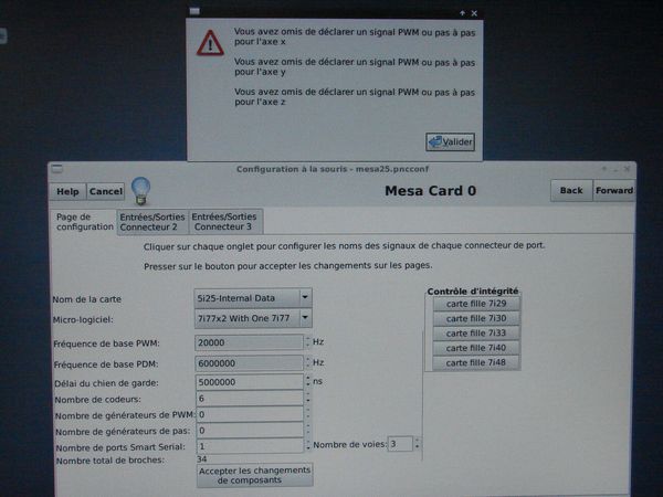

here follows my steps (of PCW) :
launch pncconf
click start
click forward
click forward
click forward
(Board name shows "5i25-internal data")
(Firmware shows 7i76x2-With One 7i76}
select 7i77x2-With One 7i77 in Firmware select box
click "Accept components Changes"
at this point 4 I/O tabs appear on top of page: I/O Connector 2, I/O Connector 3. 7I77 I/O (SS#0). 7I77 PWM (SS#1)
i have only 2 I/O tabs
and pncconf is blocked
launch pncconf
click start
click forward
click forward
click forward

What happens if you just click "Valider"?
The 7i77 config for the 5i25 does not have any PWM channels. You may still be able to link the analogue outputs.

pncconf rewinds go back
A same message asking for PWM x y z With A 7i76 ?
and also blocking
I have no 5i25 in my pci but à 5i20.
I just want an example of hal and ini configuration for 5i25 + 7i77.
and also blocking
Last edit: 09 Mar 2016 08:35 by gaston48.

Possibly a language dependent bug in pncconf
- Posts: 19914
- Thank you received: 4662
09 Mar 2016 17:57 #71297
Replied by andypugh on topic pncconfig: unable to do settings
Fiddling about with PNCConf now I am back at home, I _think_ the problem is likely to be that you have not pressed the "Adapter les changements..." button. That creates a set of tabs that let you set up the PWMs.

Replied by cmorley on topic pncconfig: unable to do settings
yes i bet if you run it in english it will work...
in a terminal try:
LC_ALL=C pncconf
Chris M
in a terminal try:
LC_ALL=C pncconf
Chris M

Hello everyone, thank you for your help
Yes its a language dependent bug in pncconf.
When I press on "Accepter les changements de composants" pncconf present only 2 I/O tabs and block.
In english, when I press on “Accept componants change” pncconf present 4 I/O tabs and continuing the configuration
Thank you very much !
