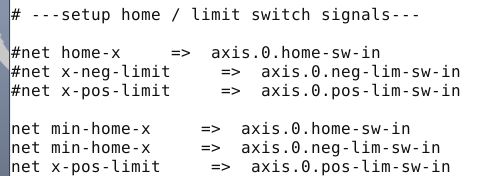

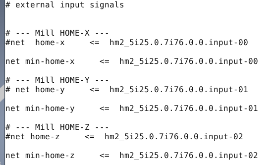

17 Mar 2016 05:09 #71771
by Clive S
Replied by Clive S on topic Is there a bug in PnCConf
Chris attached is the errors and hal file.
As you can see it shows an error when toggle machine on. so none of the axis will jog. BUT if I make my sensors trigger ie (put some metal on them so that they light up) I can then jog.
before I put your code in they all worked OK but only as home switches they would not work as limits.
I have left the original code in the hal file but commented out so you can see the difference
Thanks for the help. Clive

17 Mar 2016 15:54 #71829
Replied by cmorley on topic Is there a bug in PnCConf
looks like you need to invert the limit switches:
# external input signals
# --- MIN-HOME-X ---
net min-home-x <= hm2_5i25.0.7i76.0.0.input-00-not
# --- MIN-HOME-Y ---
net min-home-y <= hm2_5i25.0.7i76.0.0.input-01-not
# --- MIN-HOME-Z ---
net min-home-z <= hm2_5i25.0.7i76.0.0.input-02-notPlease Log in or Create an account to join the conversation.
