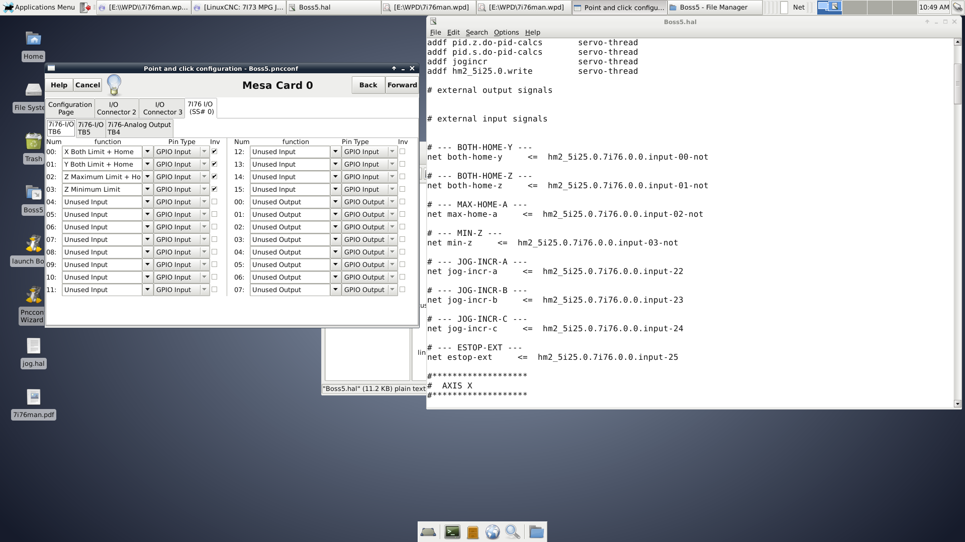

I am trying to set up limit and home switches with a Mesa 7i76 with pncconf and it does not work right. See the screen shot of the hal.ini generated for with the setting show. I also can not seem to adjust the homing options for the X axis.

What version of linuxcnc are you using?

Have a read through this forum.linuxcnc.org/forum/39-pncconf/3058...ere-a-bug-in-pncconf
I was having difficulty as well and had to update with the patch from buildbot
Replied by Clive S on topic Limit and home config errors

Looks like I found an other issue with pnccnf , when selecting mode2 for the 7i76 it ignores it and sets mode 0. If I edit the file it work until I go in and make a change to something and it get overwritten. Not sure if this is know or needs to be reported.
