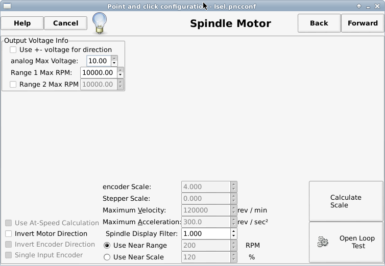

Dear I have a YASKAWA AC Drive-V1000 Vector Control Drive for spindle motor, I have try to configure it in PNCConf for control it in analog 0-10V, at 10V the motor turn 20000 RPM but on PNCConf the maximum speed allowed is 10000 RPM
Where I'm wrong?

you are not doing anything wrong. 10000 seemed like a reasonable maximum in pncconf.
You will have to adjust things manually after you have the config built.
I will look at increasing the maximum in the future.
