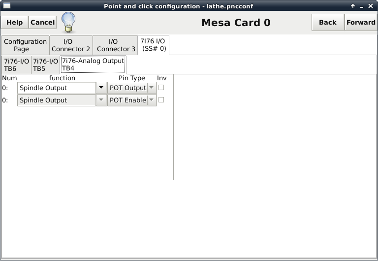

I recently upgraded to Mesa (6i25 & 7i76) boards from Parallel control on my lathe. Having some trouble understanding my error when starting linuxcnc. Trying to use Analog out to control my spindle (0-10 VDC).
My error is: ./lathe.hal:178: parameter or pin 'hm2_5i25.0.7i76.0.0.spinout-minlim' not found
Error loghal file:
ini file
A solution is good, but understanding is what I am after.
Any guiding help is greatly appreciated!

# ---digital potentionmeter output signals/setup---
setp hm2_5i25.0.7i76.0.0.spinout-minlim [SPINDLE_9]OUTPUT_MIN_LIMIT
setp hm2_5i25.0.7i76.0.0.spinout-maxlim [SPINDLE_9]OUTPUT_MAX_LIMIT
setp hm2_5i25.0.7i76.0.0.spinout-scalemax [SPINDLE_9]OUTPUT_SCALE
net spindle-vel-cmd-abs => hm2_5i25.0.7i76.0.0.spinout
net machine-is-enabled => hm2_5i25.0.7i76.0.0.spinena
net spindle-ccw => hm2_5i25.0.7i76.0.0.spindir

Finally got the spindle spinning in Pncconf Spindle Open Loop test. But, I still can't run in linuxcnc.
I currently have the spindle configured to Turn ON, CW rotation, and CCW rotation via Outputs on TB5.These worked in PnCConf, but not in linuxcnc. I did not use the connections on the spindle connector because I was not sure how to use them. Any help on understanding the 2 signals from a hookup pov is appreciated (SPINDLE ENA-, SPINDLE ENA+, SPINDLE DIR-, SPINDLE DIR+).
I am hoping my issue at this point relates to the fact that I did not use the spindle connector for Spindle ENA and Spindle DIR.

- Posts: 18122
- Thank you received: 5337
16 Apr 2016 15:03 - 16 Apr 2016 15:03 #73426
Replied by PCW on topic PnCConf Setup issue with the Spindle
The error in PnCConf (this has been fixed in later versions) is this:
net spindle-vel-cmd-rpm-abs <= motion.spindle-speed-out-abs
Note the the actual physical HAL pin is unconnected do to a net name error (the missing rpm in the top line)
The ENA and DIR outputs are simple switches.
so for example if your VFD needs a +24V signal to enable, you would wire the ENA signal like this:
+24V --> ENA+ -->ENA- -->VFD Enable input
if your VFD needed a signal to be grounded to enable you would wire the ENA pins like this:
VFD Enable input --> ENA+ --> ENA- --> GND
Last edit: 16 Apr 2016 15:03 by PCW. Reason: sp
The following user(s) said Thank You: twender
- twender
- Posts: 25
16 Apr 2016 16:28 #73435
by twender
Replied by twender on topic PnCConf Setup issue with the Spindle
Your explanation of the switch makes sense now. You indicated a simple switch earlier, but it now makes sense to me. I guess switch means switch. Thank you for your patience.
I am still a bit confused about the spindle error...Not surprising given my history of questions.
I have read the explanation of net in the Basic HAL tutorial, but I don't think I understand well enough to explain what is going on with the net command. Does the net command do the following with the line in question: spindle-vel-cmd-rpm-abs (linuxcnc code signal) is "sent to" the Mesa card analog out.
Are you indicating PnCConf has a error in creating a connection to the intended signal name "spindle-vel-cmd-rpm-abs" since PnCConf creates "spindle-vel-cmd-abs"?
- If this is the case, I assume I should edit my hal file with the correction...net spindle-vel-cmd-rpm-abs => hm2_5i25.0.7i76.0.0.spinout?
- If the above is the case, can I add this command to my custom.hal file? Will it assign it correctly since it is the last connection made to the 7i76...spinout?
- Posts: 18122
16 Apr 2016 17:30 - 16 Apr 2016 17:32 #73441
Yes (your version of) PnCConf has mis-matched net names so the desired connection
from motion.spindle-speed-out-abs to hm2_5i25.0.7i76.0.0.spinout is not made
(Note that net names are completely arbitrary, they are really just a wire or signal names )
so
net blue_wire => hm2_5i25.0.7i76.0.0.spinout
net blue_wire <= motion.spindle-speed-out-abs
will work
but
net red_wire <= motion.spindle-speed-out-abs
is legal but does not connect the desired pins
so
will work
but
Last edit: 16 Apr 2016 17:32 by PCW.
- twender
- Posts: 25
16 Apr 2016 17:34 #73442
by twender
I changed the .hal file to reflect "net spindle-vel-cmd-rpm-abs => hm2_5i25.0.7i76.0.0.spinout"
I now have the spindle turning in linuxcnc with manual and MDI controls. I also changed my wiring to utilize the switches on the the spindle connector. Works perfectly! Thanks
I also have an encoder (1000ppr, A,B, with index). It shows positional changes and speed inside of PnCConf (Though it is wrong at this point... I will setup the scale later). But, when I use linuxcnc I show no speed when the spindle runs. I assume there is another wrong signal connection. Is this the case when looking at my above hal file?
Thank you.
Thank you.
Time to create page: 0.141 seconds
