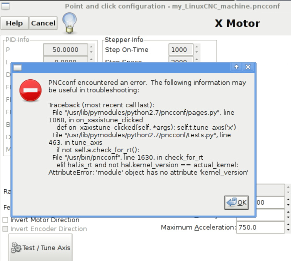

Test Axis fails to start

Test Axis fails to start was created by gandalf

My take is that this is a bug when using RT Preempt: we have 'is_rt' but no kernel module.
We probably need to split the test and check for hal.is_kernelspace before looking at hal.kernel_version
Someting like
Best is to wait on Chris for that one
Someting like
elif hal.is_rt:
if hal.is_kernelspace
# RTAI - Check version
if not hal.kernel_version == actual_kernel:
self.warning ...
else:
return True
else:
# RT Preemt
return TrueBest is to wait on Chris for that one
