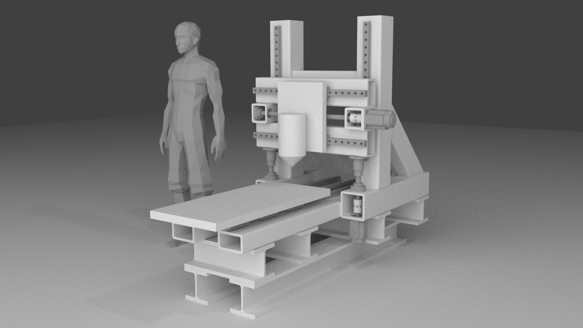

My tuning atm is capable to manage a acceleration of 1200 with a max following error of about 1mm.
(depending on load)
Just imagine, whats possible if the Drive internal hardware PID gets the control!
But for that you will need a different setup, where Linuxcnc sends coordinates and hardware calculates
the whole movement in Steps.
Look at my Z-Axis and you will understnd my need vor perfeckt movement
