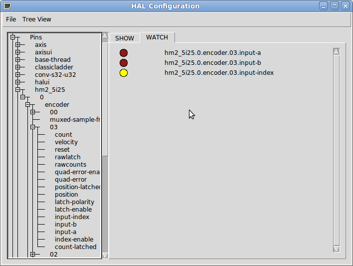

Im testing the system, but i dont know what is the name my pins of the 5i25.
I want to use the A,B,INDEX of ENC3 of my 7i85s, how can i call them in the HAL file?
Thank you.
Thank you.

Replied by andypugh on topic 5i25 + 7i85s +....
Why do you want A, B and index in HAL? You don't normally need to look at the encoder inputs in HAL, you look instead at the encoder counts and position HAL pins.

If you were wanting to use these as GPIO it is a little more complicated, because the 7i85 reads the encoders with a mux to save pins. It is reading 12 encoder pins (3pins X 4 encoders) using only 7 pins from the 5i25 port. The rest of the pins in the 5i25 port are your 8 step/dir pins, and 2 for the Smart Serial port.

Replied by PCW on topic 5i25 + 7i85s +....
Ability to use muxed encoder pins as general purpose inputs
was one reason the A,B.INDEX input pins were added to the encoder driver
Normally you would set the inputs to TTL mode
The encoder inputs are then TTL compatible with a 2K pullup to 5V

Hi again,
Ive been fighting with the 7i85s posibilities and finally i got my system working properly. Linuxnc is able to know which limit is being activated allowing the movement in the right direction of the axis, and not allowing in the wrong direction.
The 7i85s, as PCW said, can handle these PINS as GPIO´s too. It works fine.
PCW i will send you and email requesting you a Spin1x right now.
Thank you all.
