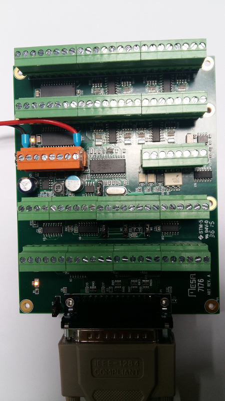

I'm testing with a mesa 5i25 and 7i76
I flashed with the command:
sudo mesaflash --device 5I25 --write 5i25_7i76x2.bitControl :
sudo mesaflash --device 5I25 --verify 5i25_7i76x2.bittour-mondial@tour-mondial:~/Téléchargements/5i25/configs/hostmot2$ sudo mesaflash --device 5I25 --verify 5i25_7i76x2.bit
Checking file... OK
File type: BIT file
Boot sector OK
Verifying EEPROM sectors starting from 0x100000...
|VVVVVVVVVVVVVVVVVVVVVVVVVVVVVVVVVVVVVVVVVV
Board configuration verified successfully.
The CR1 and CR2 LEDs are illuminated
mesa 5i25 card:
W1 - UP
W2 - UP
mesa 7i76 card:
W2 - left --> power pc db 25
W1 - right--> power 24v ext
I run the command:
halrun
halcmd: loadrt threads name1=th period1=1000000
halcmd: loadrt hostmot2
halcmd: loadrt hm2_pci
halcmd: addf hm2_5i25.0.pet_watchdog th
HAL:[b] ERROR: function 'hm2_5i25.0.pet_watchdog' not found[/b]
<stdin>:4: addf failed
halcmd: addf hm2_5i25.0.read th
halcmd: addf hm2_5i25.0.write th
halcmd: start
halcmd: setp hm2_5i25.0.7i76.0.0.output-07 true
<[b]stdin>:8: parameter or pin 'hm2_5i25.0.7i76.0.0.output-07' not found[/b]What is going on ????
A flashing problem ????

Try the sequence again, but try "show pin" to get a list of the pins.
The likely problem is that the GPIO system is powered by the field power. With no field power to the GPIO section those pins won't be enumerated.

Thank you for your help.
I do :
halcmd: show pinHere's the answer :
No reference to 7i76 card
Why there are 24 V or 17.6v to terminal TB5 and TB6 ???

- Posts: 19908
- Thank you received: 4660
You need to wire TB1 to the power supply. (correctly, and carefully).
See page 10 of www.mesanet.com/pdf/parallel/7i76man.pdf
To be absolutely sure you have the correct polarity, pin 1 has a square solder pad.
You don't need to connect all VFIELD, they are commoned on the board.
Look also at the W1 setting and VIN power source paragraph on Page 2.
- finemeca
- Visitor
The black wire is ground TB1
Red is the + 24v
Can there be a malfunction of the card ???
- Posts: 19908
- Posts: 18122
- Thank you received: 5337
Also, if the 5I25 firmware needed updating (if you got the cards as a set, this is not necessary)
you need to power cycle the PC to load the new firmware, or use mesaflash's --reload command:
sudo mesaflash --device 5i25 --reload
