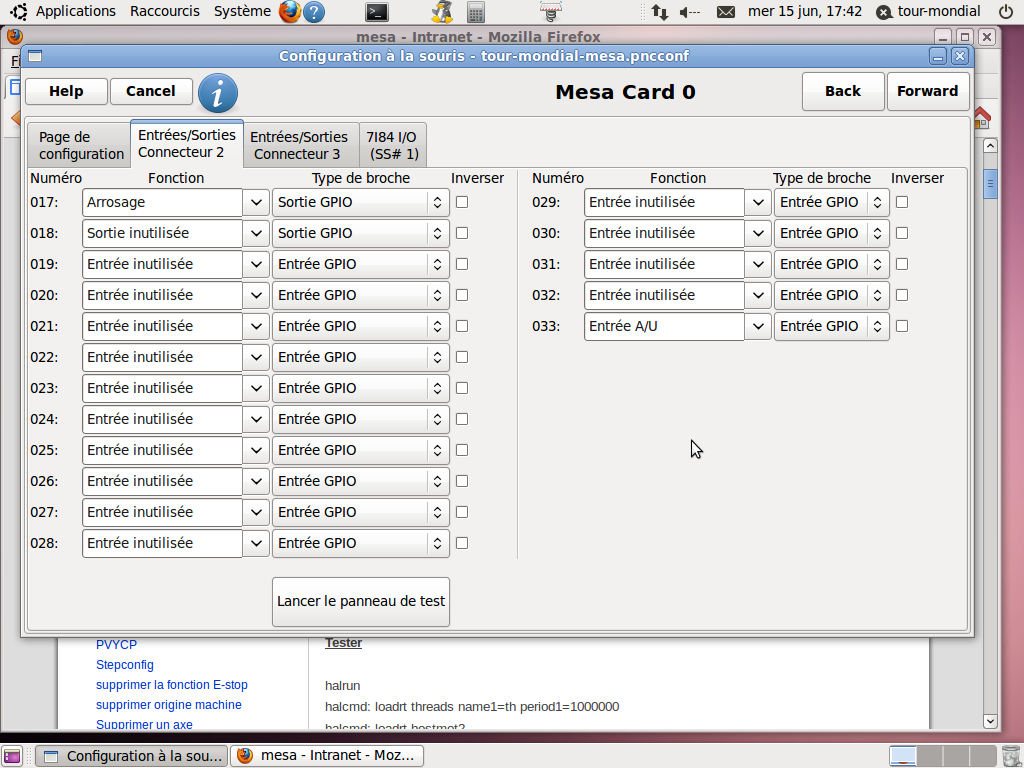

I continue my tests with the mesa and 5i25 7i76 cards.
In the doc :
www.linuxcnc.org/docs/html/drivers/hostmot2.htm
I do the command:

An example with pncconfig:
# --- COOLANT-MIST ---
setp hm2_5i25.0.gpio.017.is_output true
net coolant-mist hm2_5i25.0.gpio.017.out
Installation du driverMy question is how to link an input or output TB5-TB6 ???
Thank you in advance.

on 7i76 or is this output:
hm2_5i25.0.gpio.017
Where is the gpio 017 ?????
With a multimeter on TB5 and TB6 I only 0V to terminals ???

hm2_5i25.0.gpio.017
That is a specific pin on the DB25 connector of the 5i25. You won't be using that.

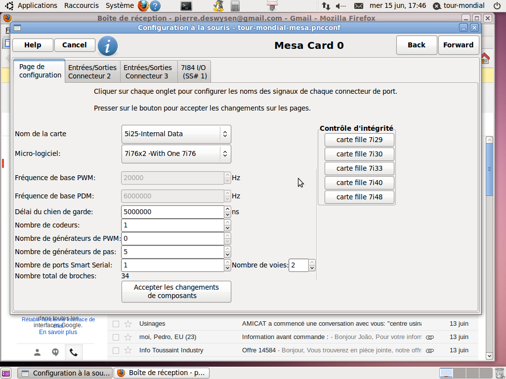

- finemeca
- Visitor
hm2_5i25.0.gpio.0xx refers to a pin if unused for anything else on the 5i25. The pin hm2_5i25.0.gpio.017 would be the first pin on the 2nd port (the header pins on the top of the card) of the 5i25 card.
A bad choice in pncconf?
I make you some screenshots

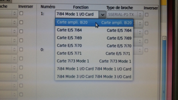

- Posts: 19908
- Thank you received: 4660
Perhaps you need to press the "Accepter..." button to get the 7i76 to show up. (or, possibly, there is a bug in Pnnconf in French)
- finemeca
- Visitor
Not at the moment is only the 5i25 and 7i76
This is the choice that is in the connector tab 3
