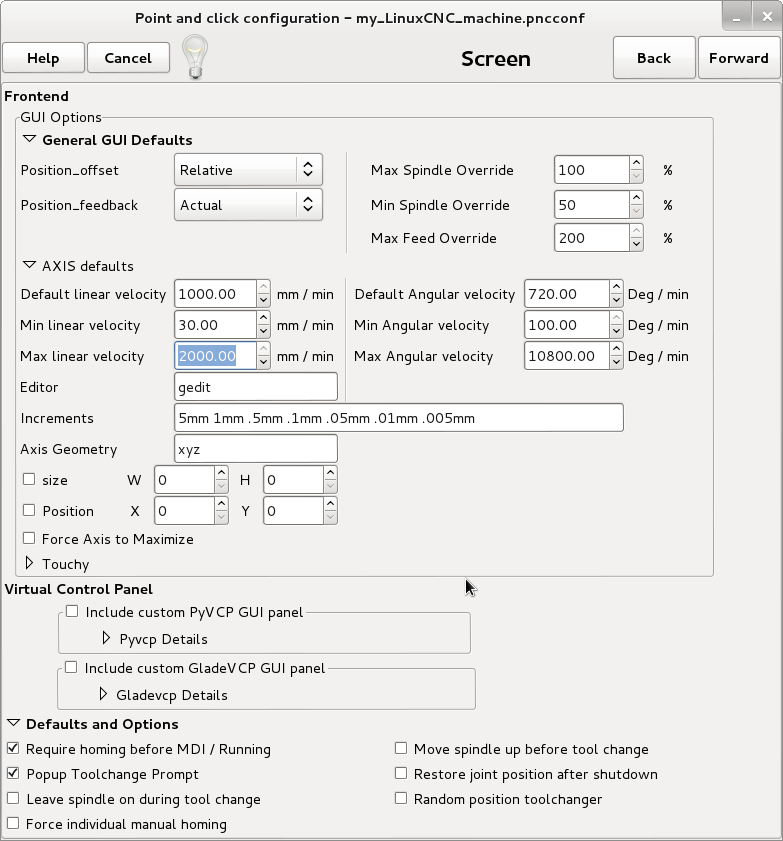

In pncconf i can't set more that 2000 mm/min max linear velocity
and default linear velocity i can't set more than 1000 mm /sec.
is there any fix for this ?

Yes there is, after you finish this, just open and edit the .ini file, you can set whatever velocity you want or whatever your machine can handle.
