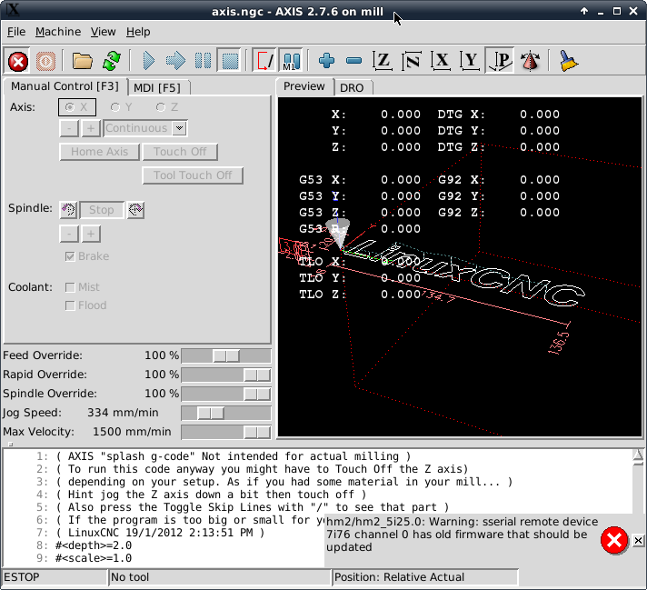

I amusing an older 5i25 and 7i76 combo that i bought a few years ago
when i open linuxcnc i get this message
I have updated the 5i35 card
but when i try to update the 7i76 this is what i get
see attached image

[ 1570.232326] flash command
[ 1570.234515] hm2/hm2_5i25.0: firmware hm2/sserial/7I76R14.BIN not found
[ 1570.234519] Firmware Flash Failed

This appears to be the problem. Do you have that file?
Replied by andypugh on topic problem updating 7i76 to r14

I have the file
I put a copy here
tiered@mill-pc:/lib/firmware/hm2/7i76$ ls
7I76R14.BIN
is this the right location ?
also thanks for the fast response
I put a copy here
7I76R14.BIN
- calvin.d
- Posts: 80
02 Aug 2016 12:39 #78300
by calvin.d
Replied by calvin.d on topic problem updating 7i76 to r14
ok got it needed to move a copy to
lib/firmware/hm2/sserial/7I76R14.BIN
thanks
machine is not moving yet, but at least linuxcnc start without errors now
Thank You
C
thanks
Thank You
C
