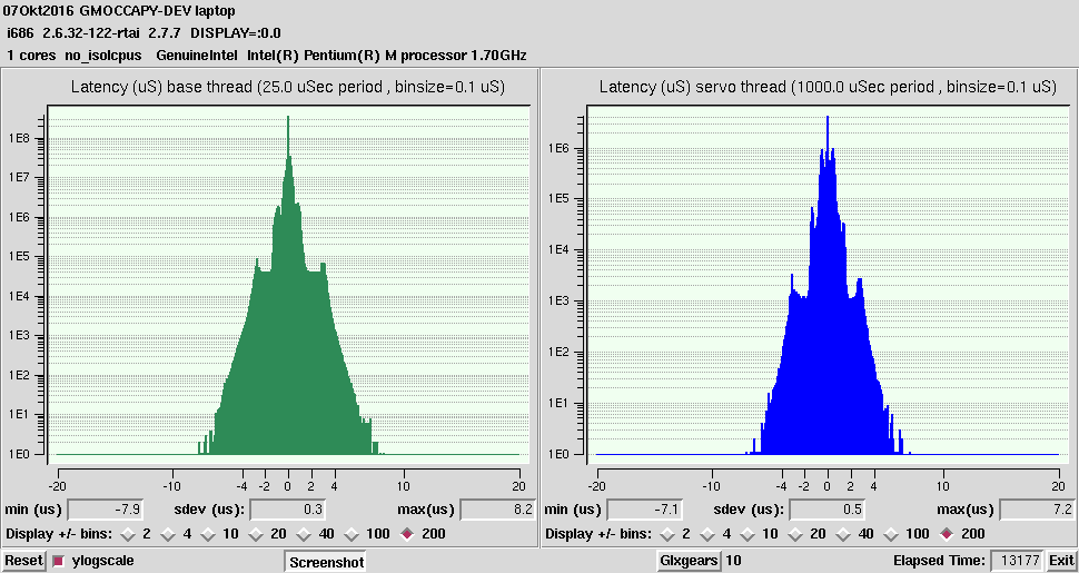

Hello,
I'm in the process of converting my lathe to cnc, finished the mechanical changes and now comes the software.
I'm using stepper motors and an ABZ encoder with 360ppr for spindle.
I saw that Mesa 7i76e connects through ethernet and seems to have all that 7I76-5I25 PLUG-N-GO KIT has
I have already wasted some money on some windows based solutions, so before I order the board I would like to know if there are any special conditions my pc has to meet in order to have this board working at it max potential.
Does the latency matters if I'm using an external board?
Right now I'm using a desktop pc, but with this ethernet board in the future I might use a laptop. Do you guys think a laptop configuration would work with this board?

Latency does still matter, but the latency requirement is much less than that required for software stepping.
A laptop can work, but I wouldn't recommend it, and most aren't capable of good enough latency.

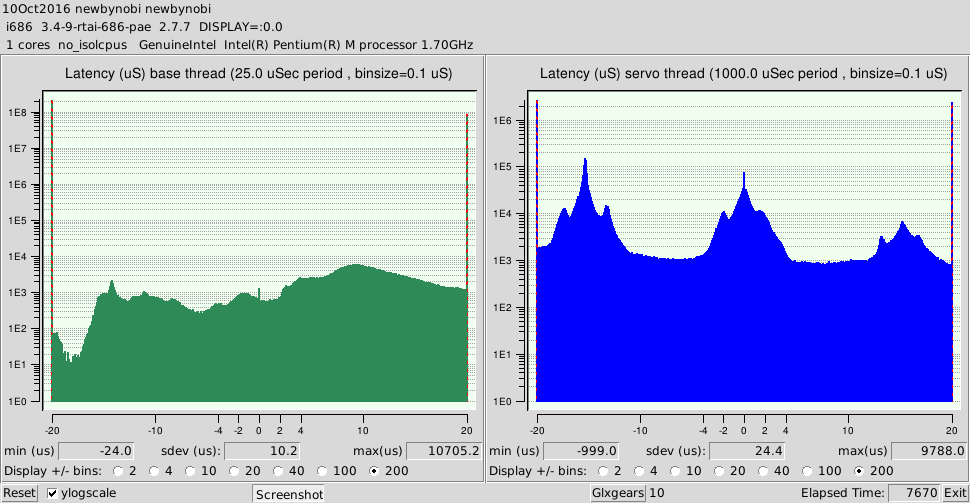

Remember with an Ethernet Mesa card you have to use a Preempt-RT kernal rather than RTAI. An older single core processor like that might not have enough horsepower to run a Preempt-RT kernel well, and a laptop with all of its power-saving features disabled may run dangerously hot.

You may want to try again, your histogram image, does not show that the preemp-rt kernel is the one running.
