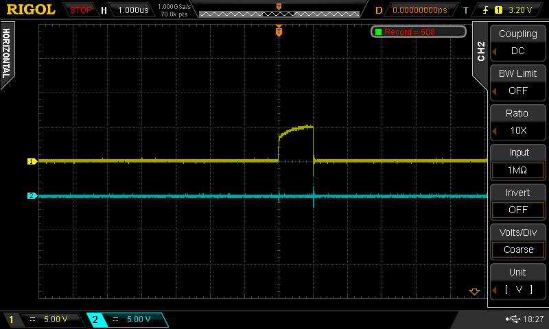

14 Dec 2016 10:53 #84101
by mikikg
Replied by mikikg on topic 7i80HD-25 configuration
I got the pulses, outputs are mapped on P1 connector (instead P2) but I understand, that is the difference of 7i80 vs "pretended" 5i23 card.
Signal is quite good, have very fast rising and falling edges, in general that work correct, see captured screen from scope, I capture only one pulse from train of pulses ...
