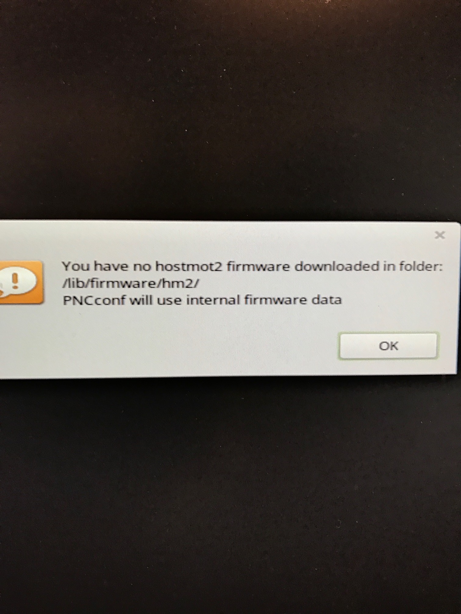

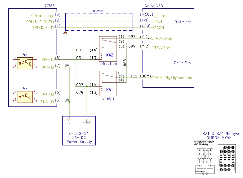

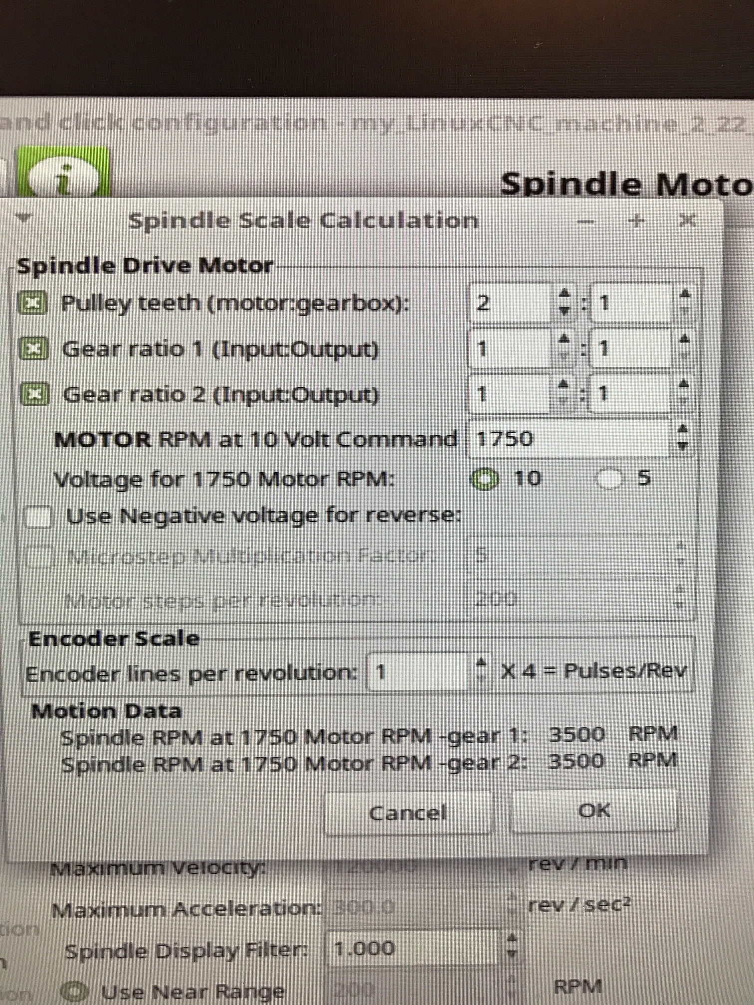

PCW,
Thanks but that didn't work. After I made that change all I hear is the relay clicking in both the spindle override and M commands too ( m3 and m4 Sxxx ).
Interestingly when I remove the check mark next to "Range 2 max RPM I have similar results ( no motor rotation from the motor at all ) but I believe the relay clicks the same way.
I have also enclosed a picture of a dialogue that comes up when I first open PnCConf stating I its using the firmware on the card because it isn't seeing hostmot2 in the lib/firmware/hm2 folder. Also is a picture of my gear / pulley settings. More importantly, possibly, I've enclosed the schematic of how my relays are wired to the 7i76e and Delta VFD-e.
( note, I changed my rpm settings to 3500 from 7000 because I changed the HZ from 120 to 60 in my VFD )

20 Mar 2017 01:47 #89925
Replied by cmorley on topic Mesa 7i76e-spindle speed variable via spindle override but not via G-code / M
Since you seem not to be using two ranges, please try with only one range selected.
Let us know if that works.
Looks like a bug in pncconf with two ranges.
(The scale ratio that Peter pointed out is wrong and so is the scaling for ranges in the main HAL file.)
Chris M

20 Mar 2017 02:19 #89927
Oh I am starting to see the idea here I think..The original scaling in the INI was correct.
OUTPUT_SCALE = 1
OUTPUT_MIN_LIMIT = 0
OUTPUT_MAX_LIMIT = 1
meaning an input of one gives 10 volt output.
In the HAL file, requested RPM is scaled to this range 0-1
ie 3500 RPM = 1
1/3500 = .000286
so the scale gain should be the same....checking your HAL file...
OUTPUT_SCALE = 1
ie 3500 RPM = 1
1/3500 = .000286
