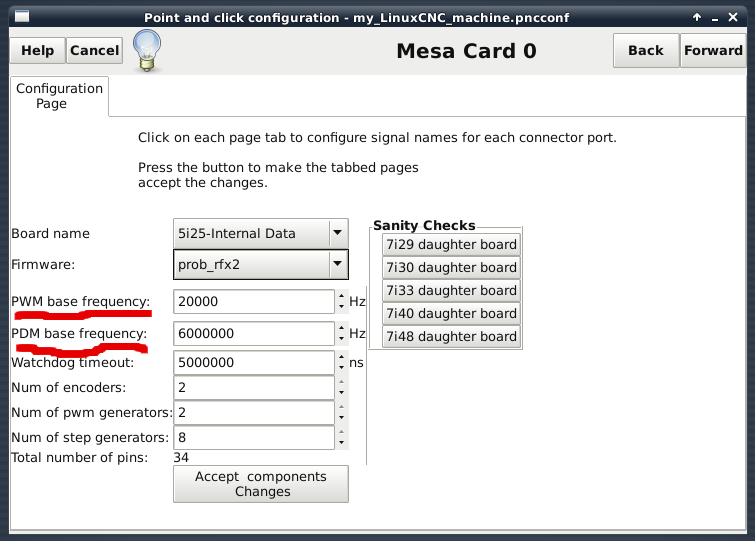

Hello
I am going to use 5i25 with common BOB .
I use a wizard PNCconf to set values (attachment).
What value should I set for the base PWM and PDM base?
Is it a PWM frequency of spindle inverter?
Thanks a lot.

Replied by PCW on topic Mesa 5i25 with common breakout board
I think the PWM pin is not on a usable DB25 pin for that breakout board
so best disabled
If you need PWM and use that breakout, you would need to steal one of the step/dir/or enable lines
so best disabled
