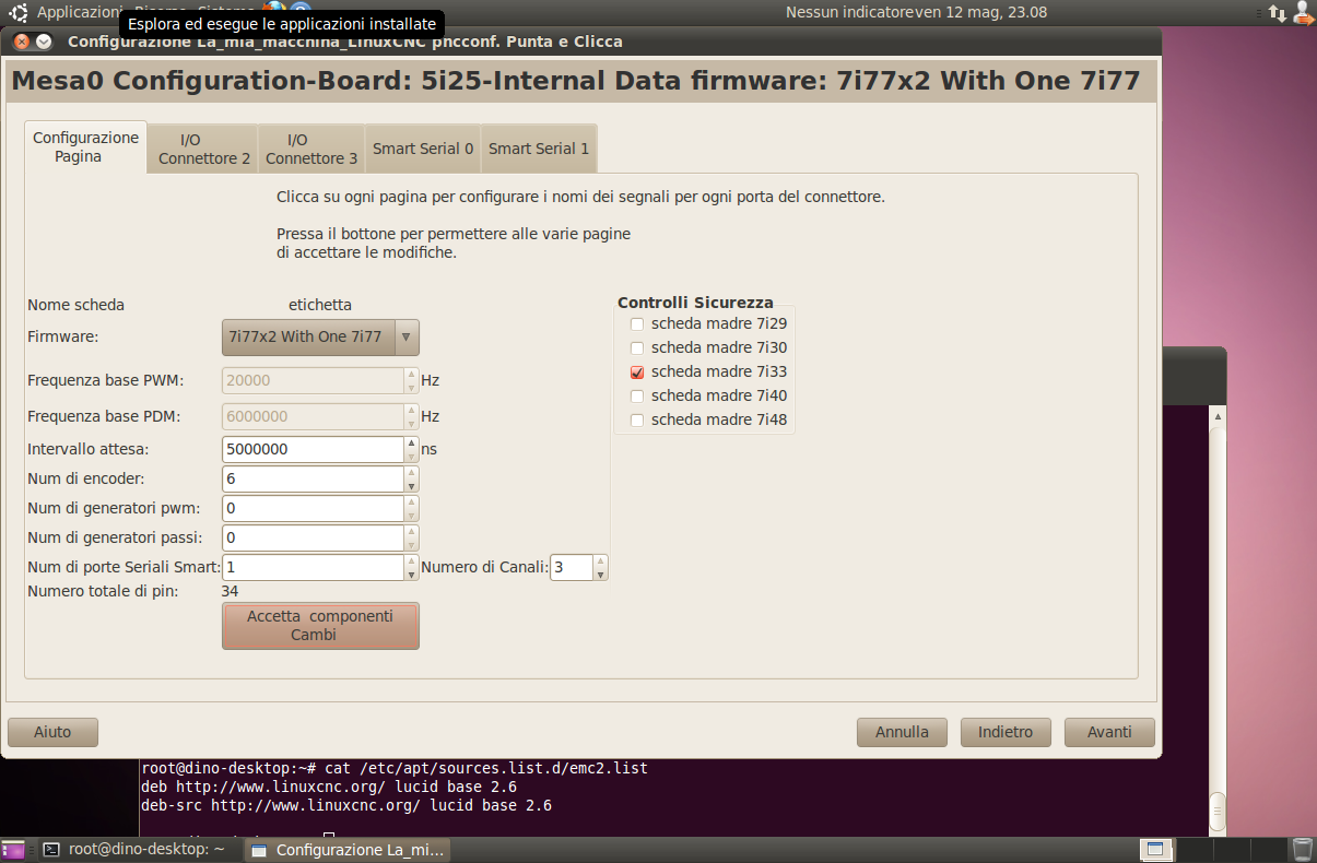

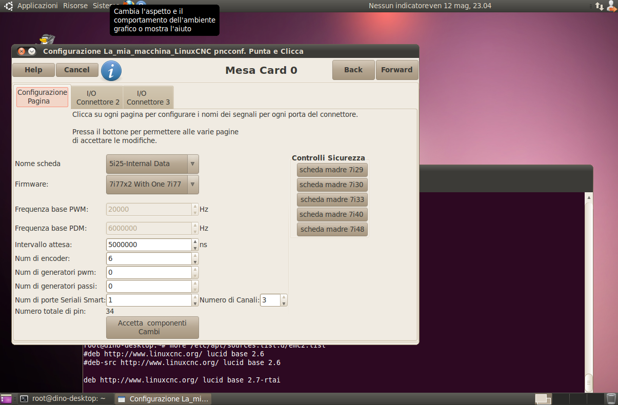

13 May 2017 22:34 #93173
Replied by cmorley on topic PNCconf (linuxcnc 2.7.8) not working for Mesa 5i25+7i77
Ah yes I believe I remember a problem that was cause by language.
Can you try and run it in english and see if the screen works properly.
I'll see if i can find the terminal commands to do that..
- Posts: 7368
- Thank you received: 2182
13 May 2017 22:46 #93174
Based on this page:
makandracards.com/makandra/28205-linux-r...le-than-your-default
in a terminal run the command:
locale -a
to see what languages you have we need english to test this something like:
en_US.utf8
then run pncconf using this language:
LC_ALL=en_US.utf8 pncconf
Every thing should display in english and hopefully work properly.
Chris M
locale -a
en_US.utf8
Chris M
The following user(s) said Thank You: dinodf
- dinodf
- Posts: 40
- Thank you received: 9
14 May 2017 15:39 #93198
by dinodf
Replied by dinodf on topic PNCconf (linuxcnc 2.7.8) not working for Mesa 5i25+7i77
I just checked with "LC_ALL=en_US.utf8 pncconf" and it works correctly, so a temporanaly solution may be to set the locale in the package, setting it to en_US.utf8 for all users; also because not all strings are localized in italian.
